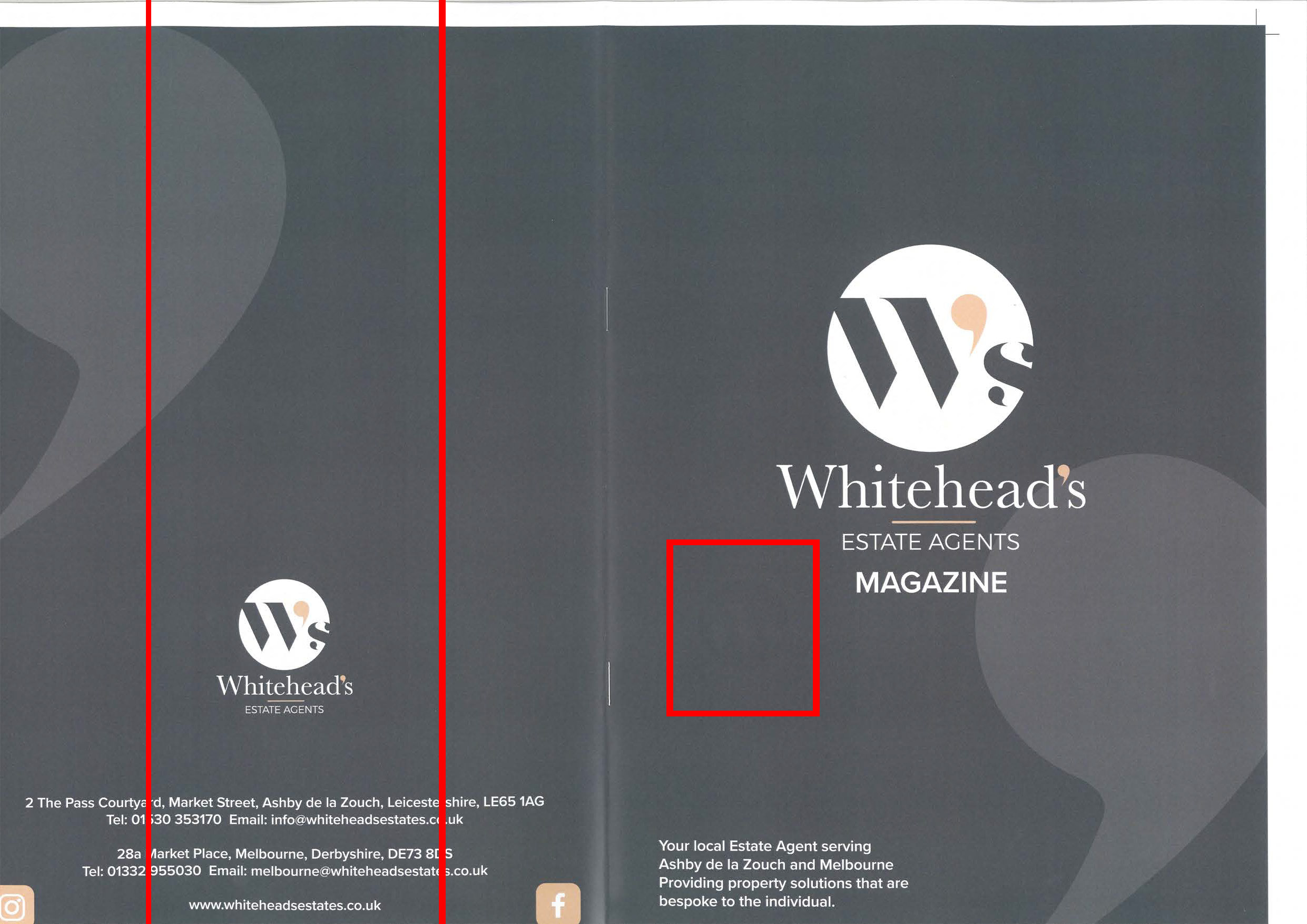

So I was printing a booklet on Friday and I noticed that the logo from the back page was appearing faintly on the front cover and getting some banding issues. See photo below. Has anyone else had this issue?
I did ring for an engineer today and he said its to do with the image transfer voltage. So we changed all the image transfer colours down to 80% and it has now made it disappear. However that now does affect the overall colours slightly.
The stock I am printing on is SRA3 150gsm silk.
The grey background is made out of the following C57 M46 Y46 K34

Sorry just to clarify, have you created a custom paper profile and adjusted the Image Transfer Voltage in that to 80%?
I use the numbers rather than %, not that that should matter, but I've never experienced a colour change from doing so. Given your cymk breakup of grey I suppose this could be a possibility as slight difference will effect greatly.
Have you tried setting stock to next weight up, just to see?
Is it just the image on my screen or does the grey look alot different at the top compared to the bottom? If so density uniformity needs to be run.
In my experience this kind of ghosting is caused by fusing issues. Do you have a spare fuser you can swap in?
^^^ This.
Measure the distance between the original and ghosted image/s, to see if equal to the circumference of the fuser roller.
Yes I have created a custom profile for that paper stock and job.
No I haven't tried changing the stock weight setting for that. But I did try a 250gsm silk and it did it on that as well.
Yes the top is different compared to the bottom, I presumed it was because of me changing the transfer voltage. I shall give the density uniformity a go.
No I don't have a spare fuser, as its a brand new machine which we only got in January.

I don’t think that you’ll be able to get rid of the light banding in a screen like this but sometimes you can reduce the visual effect by changing the printer screen mode on the Fiery. A little experimentation may be needed to reduce the banding to where you’re happier. Hopefully running the density uniformity helped you with color balance across the sheet.
