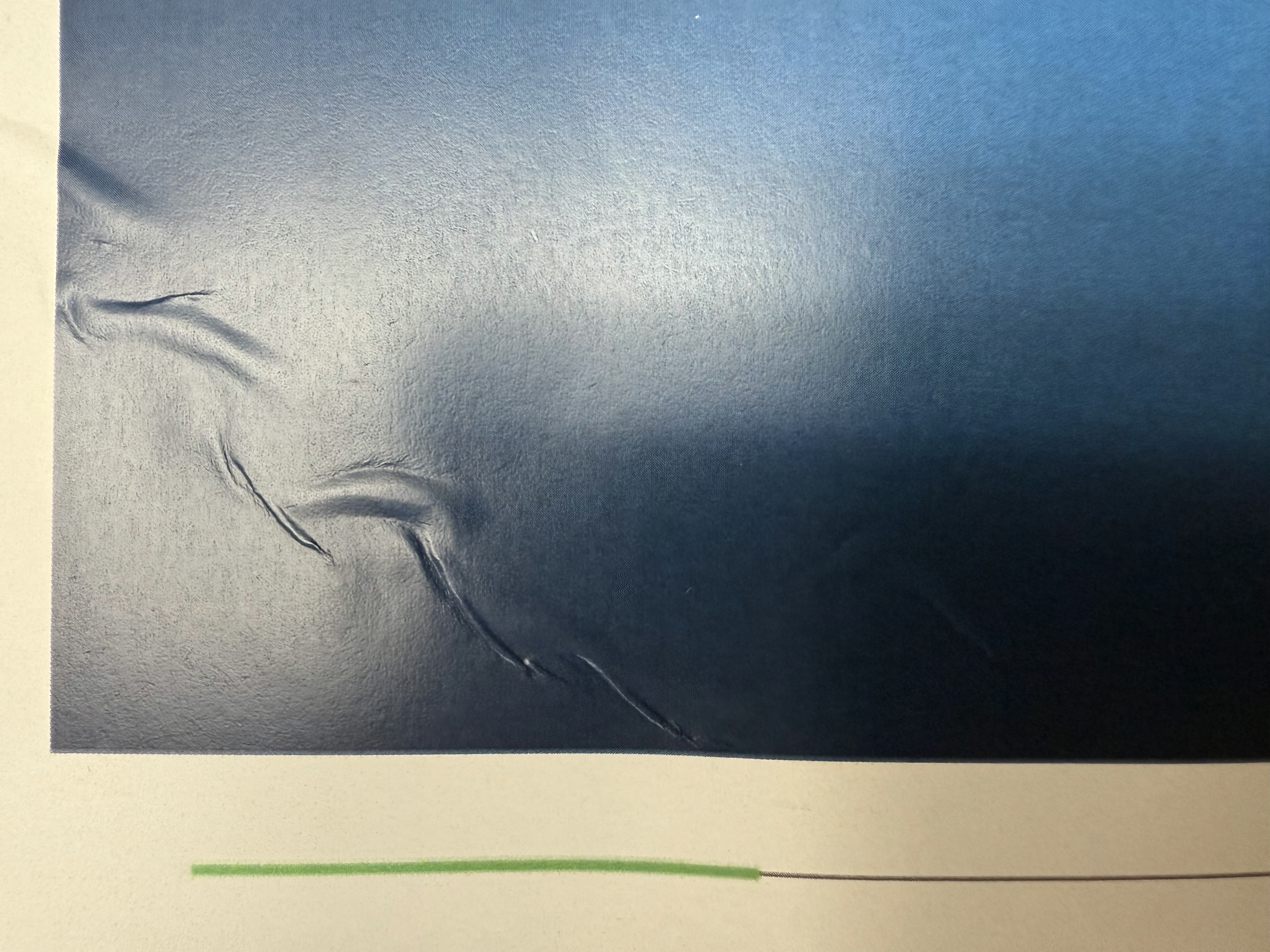

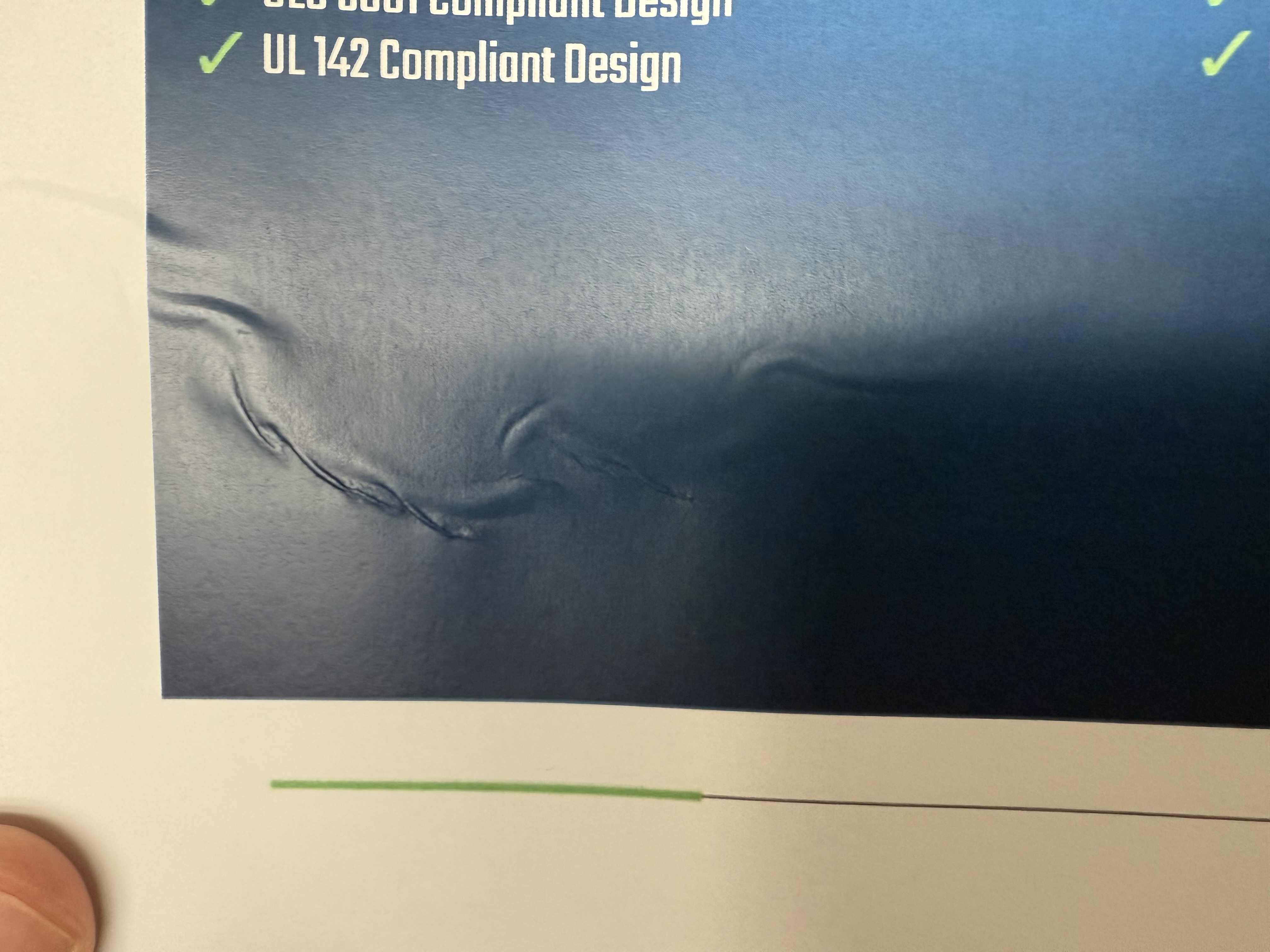

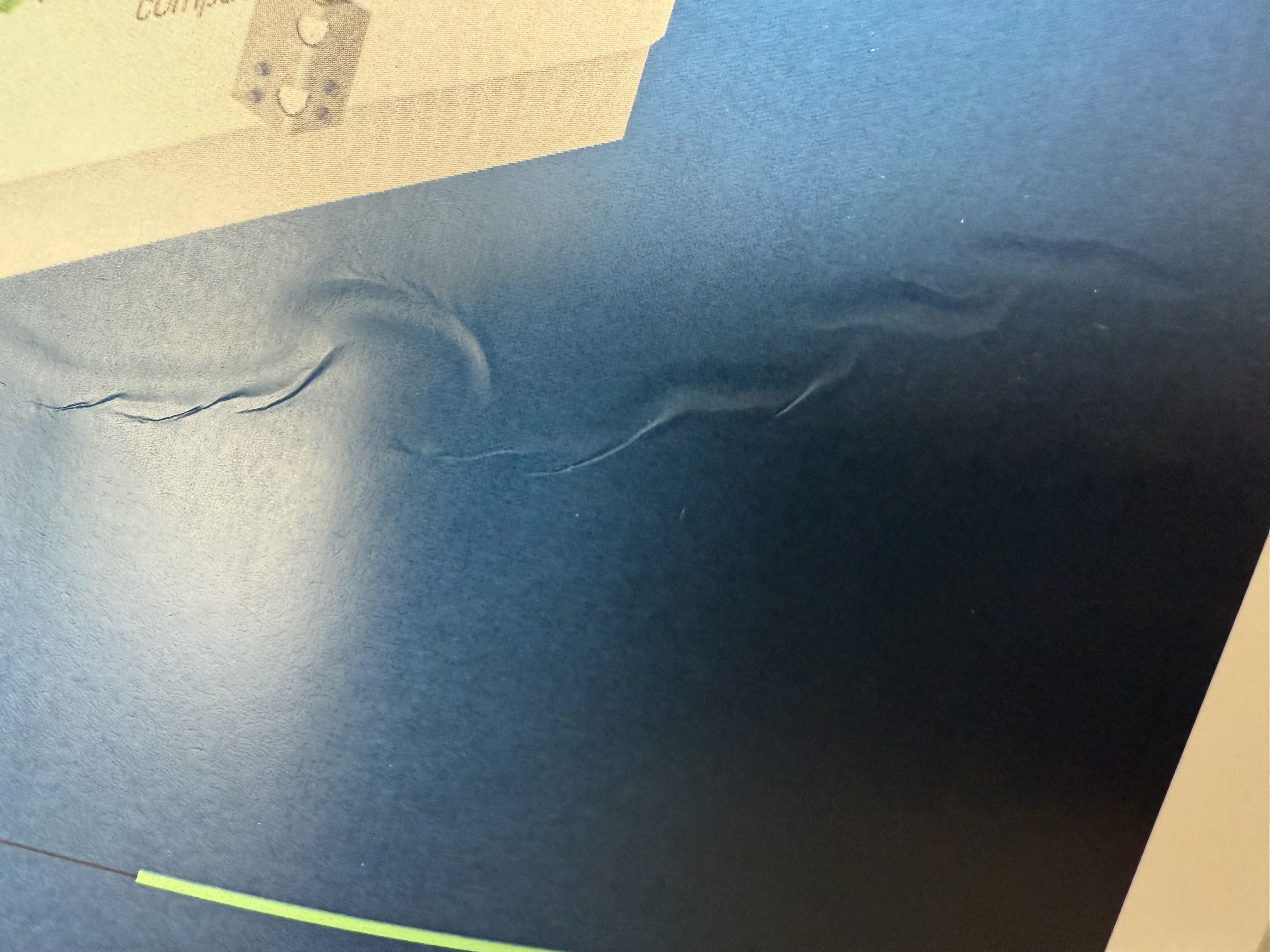

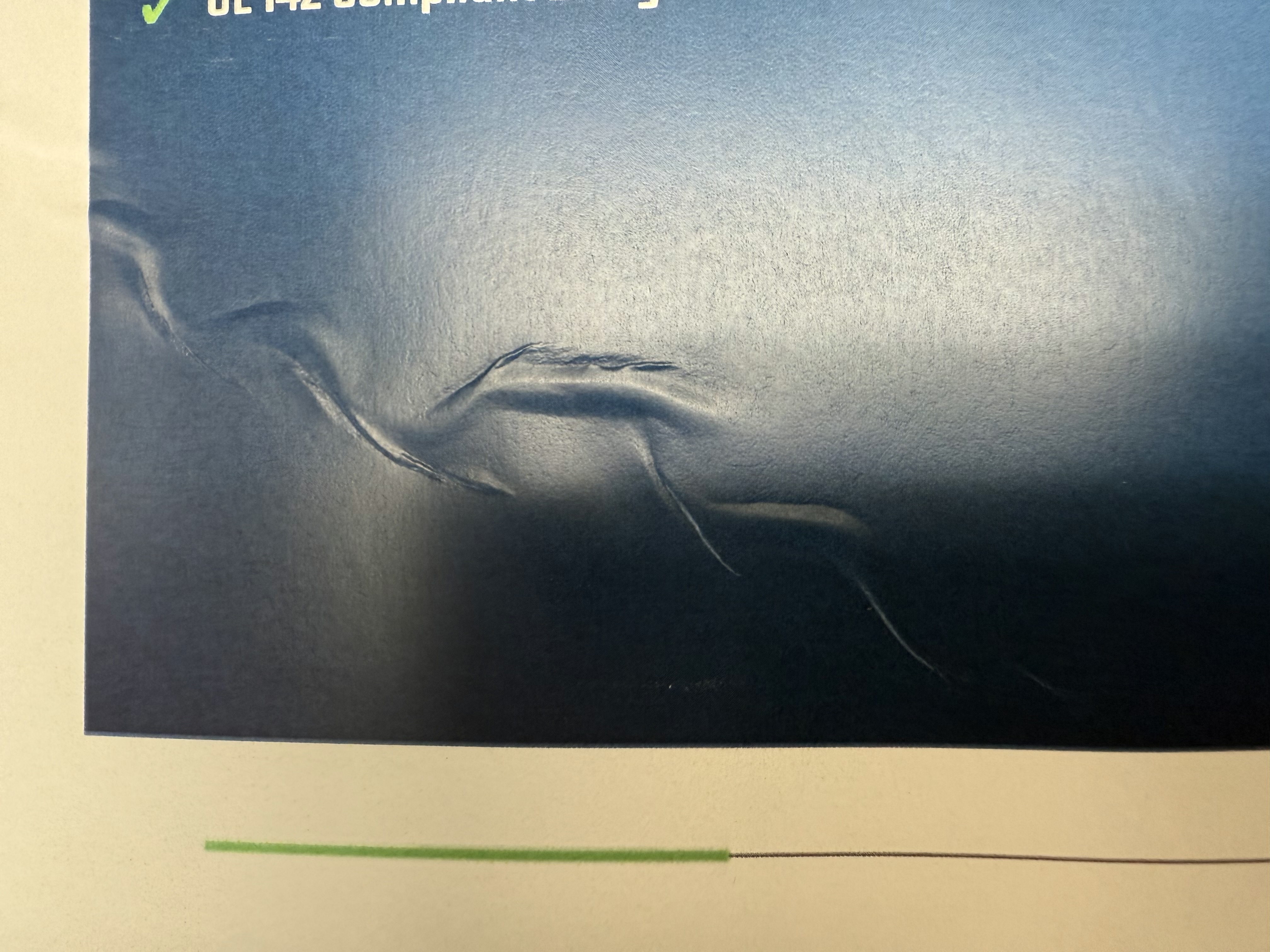

Does anyone else ever get this type of creasing marks on their versant 280 when printing on 130gsm-170gsm silk SRA3 paper (see photos) only affects bottom right corner. I have the fuser temperature set low. Prior to printing the paper doesn’t have any crease marks and I have tried two different brands of paper. It doesn’t happen on every sheet, sometimes it inconsistent and then another time it’s every sheet.

I had very similar marks on a 180.
Once unit has cooled down, take a look at the Slip Sheet on Fuser Heat Belt
It may be folding up underneath the belt and coming apart.
Had similar issues running lighter stock. Fuser was replaced and issue was much better but wasn't completely resolved until the pressure roller under the fuser unit was replaced. No more wrinkles after those items replaced.
