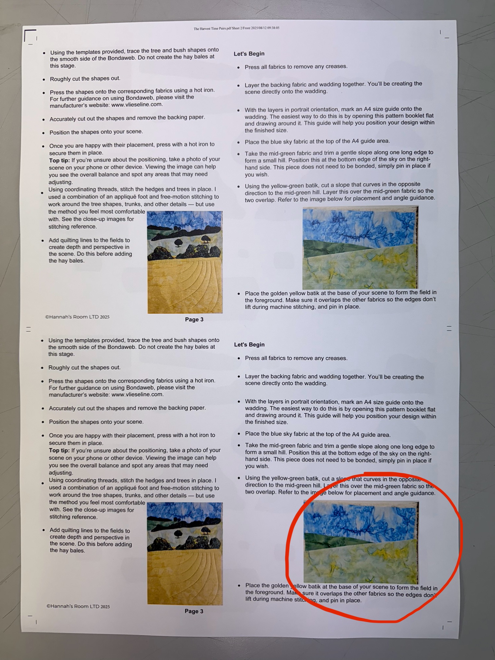

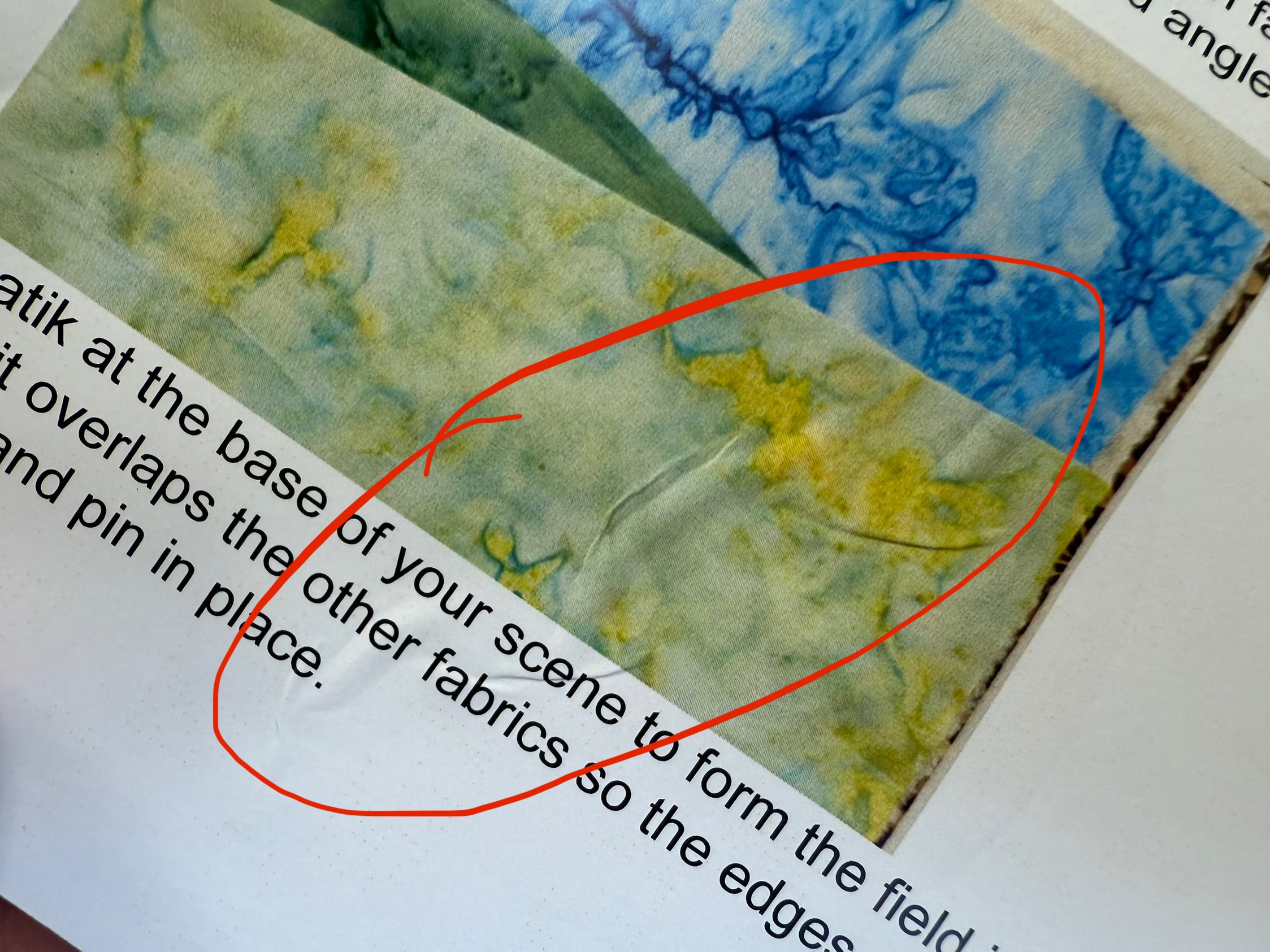

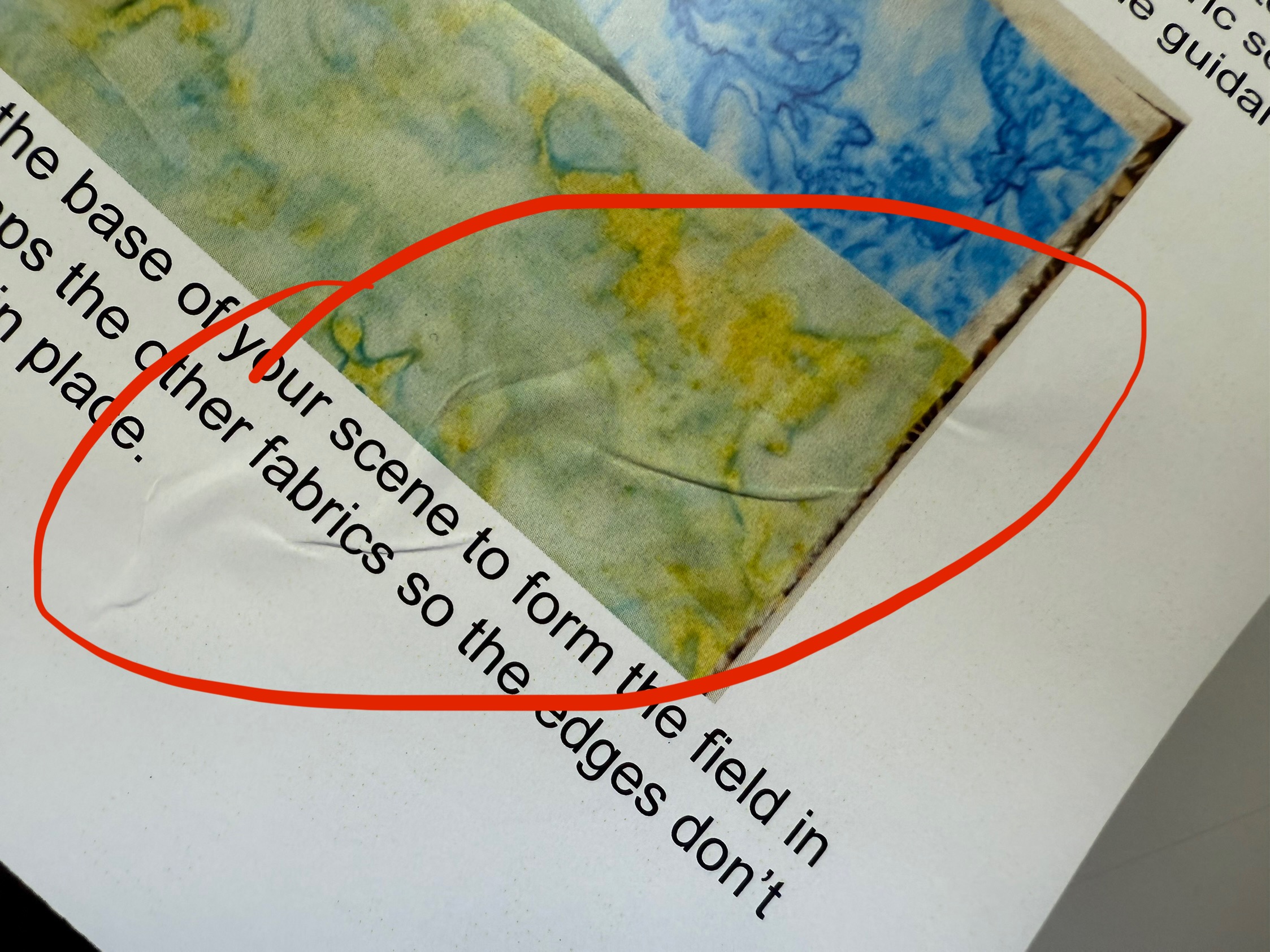

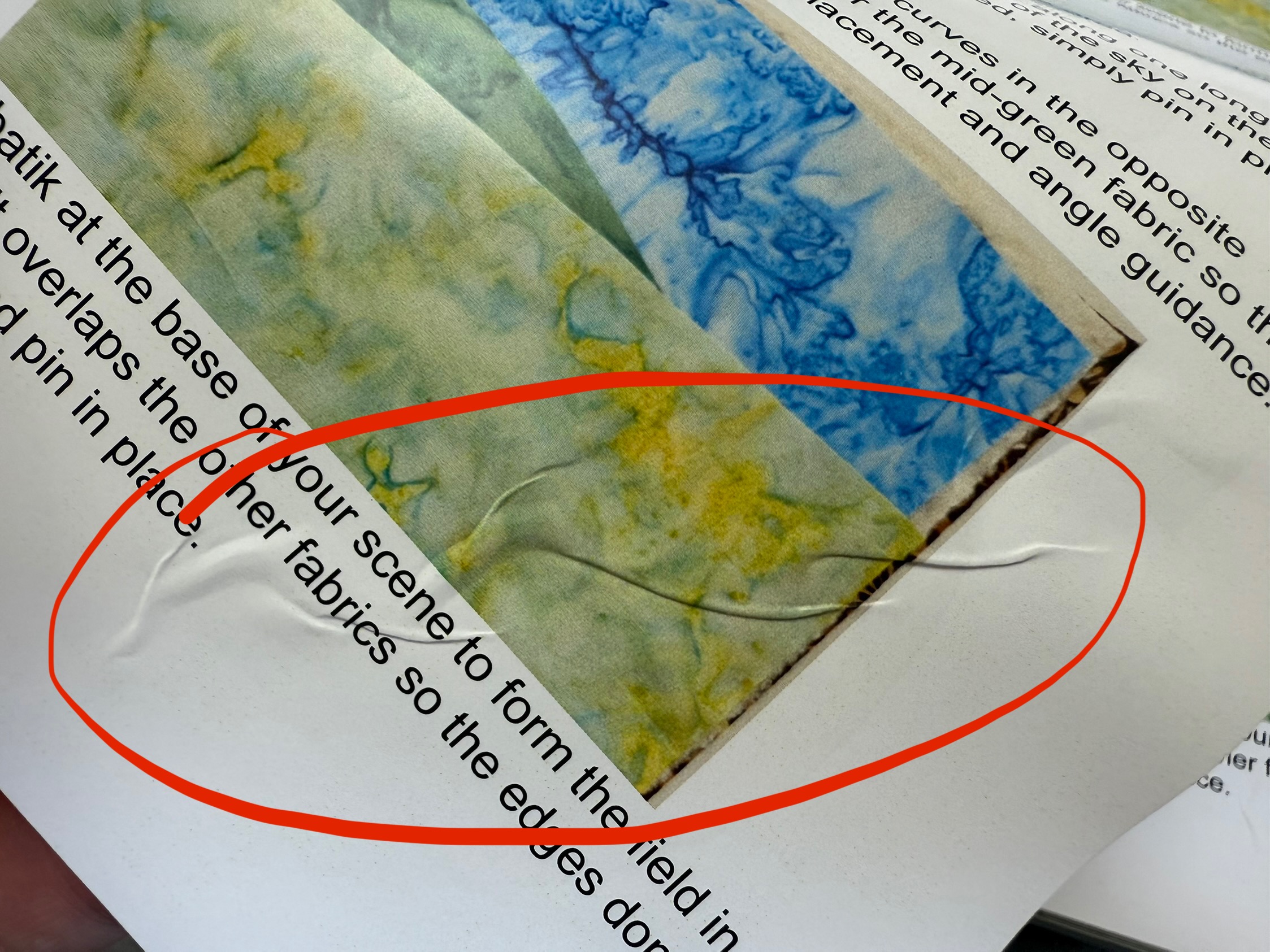

I know why this creasing occurs it is because it’s a combination of the decurler rollers and pressure roller. This tends to happen every 1-2 months. Once engineer has replaced it clears.
I’m just curious does anyone else have this issue? It always happens on 100gsm silk up to to 150gsm silk only. The temperature setting is set to low for this type of stock. Only happens when duplicating as well.

what kind of volume in that period? The "failure" can be either in the upper belt assembly or the lower pressure roller.
it could also just be your stock... grain direction, natural curl, humidity
oh, and also are you changing your suction filters (the one in the back) regularly?
