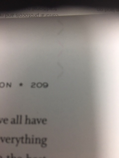

Thanks for your replies. here is a photo

It this on trail edge or lead edge of side 1 or 2? And on the same place trail edge to lead edge or side to side or both? Only on Duplex or does it show up on single sided?
its on both sides and even when the second side of the book is blank
If you don't want to give us more information than this don't expect much help here. Just a guess then. I would look at a roller in the duplexing unit. Measure the distance between the ridges and see what roller has that circumference.
That doesn't look like the registration marks I have seen, unless they changed them for the Versant.
From your one photo, to me it looks like some creative person's leftover design in the margins, instead of being trimmed or bled off. What happens if you print that page only say 10 times? What about if you rotate the image?
