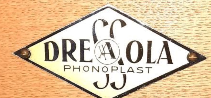

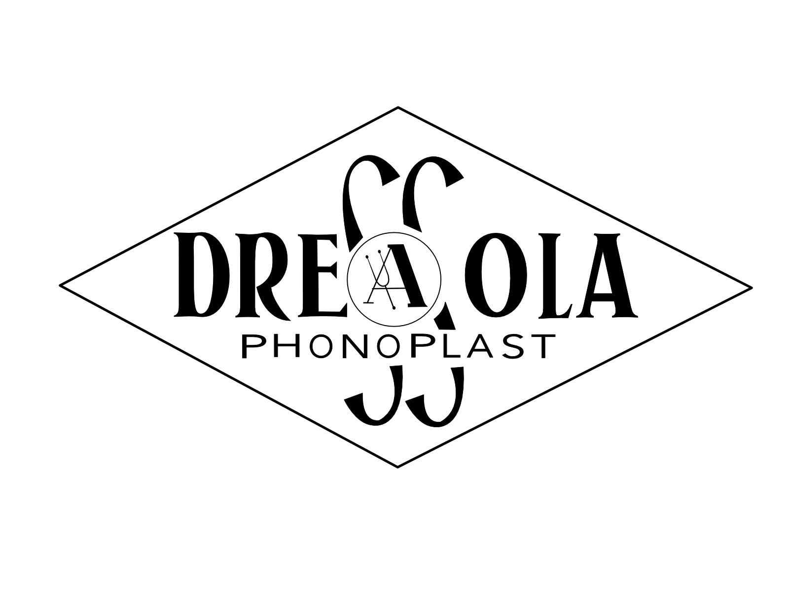

The more I dig into this topic, the more I come across typefaces that are not recognized by any of the "fontfinder" type programs, or any of my Sherlock Holmes-esque powers of deduction. So I bag dibs on the term: "Extinct font!" Some of these logos are over a hundred years old by now from companies long gone and I find it fascinating.
Recently for the restoration of a Dressola gramophone I recreated the logo from a 72ppi picture found on e-bay, it´s not an exact replica but I find it close enough to use.
What do you think?
I also think that I have found the original print method used at the time, I believe it to be the so-called "Chromolithography" procedure. Basically 4C stone printing using a Senefeld type press.
In Munich, close to where I live there is a Lithograph in the city center and I plan to swing by and take a look in the near future.
