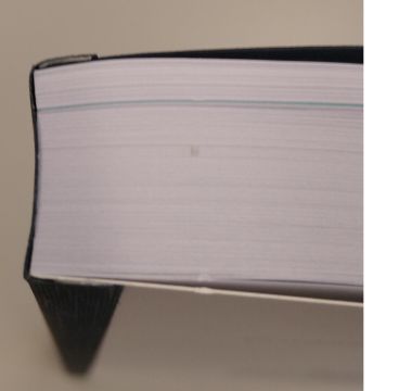

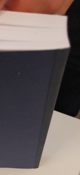

Hi folks,
Could you let me know what equipment is required for this type of bind?
Supplier described it as 'glued spine'. Cover is 300gsm and pages are 100gsm.
Many thanks,
Ben
bcr
Thanks all. So a Powis Parker Fastback machine would do this?
I want to bring this type of binding in house. And perhaps hard covers as well and I saw PP make hard cover accessories for the fastback machine...

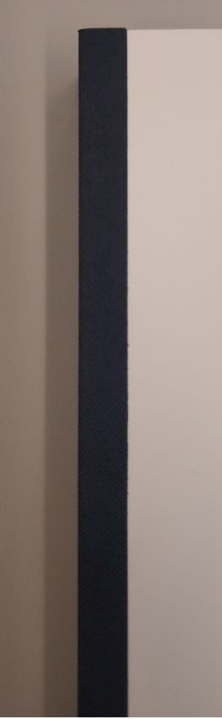

Just to update on this.. I ordered a Powis Parker Fastback 20, and so far I am very happy with it.
It had a minor fault on delivery which was quickly rectified by the supplier. Once warmed up it binds documents in seconds. Less fiddly than wire binding. Non-technical colleagues are very happy with it, as it seems to be idiot proof.
Occasionally the alignment of some of the spines might be out by about a millimetre or so, but no issue for us to trim that off the top or bottom. Also it was about 1500 EUR less than the prices typically listed online for it.
