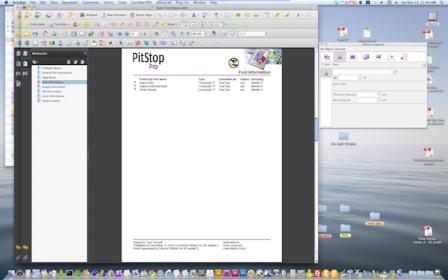

Attached is a Pitstop 10 Preflight report where it flags fonts as composite fonts.

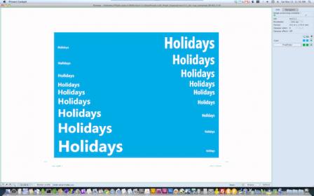

I can verify on my Prinergy 5.1.2.2 I get the same results as you. It looks fine all the way up through the screened VPS at 600 DPI but when you get up to 2400 DPI to output plates the H is hosed in places. I would submit a support request with Kodak.

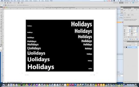

Well, if you use PhotoShop to rasterize the PDF at 800 DPI you see the same problem as Prinergy. Even the one that I "fixed" has this problem. So there is something else going on. We'll have to play a bit more and see what we can come up with...

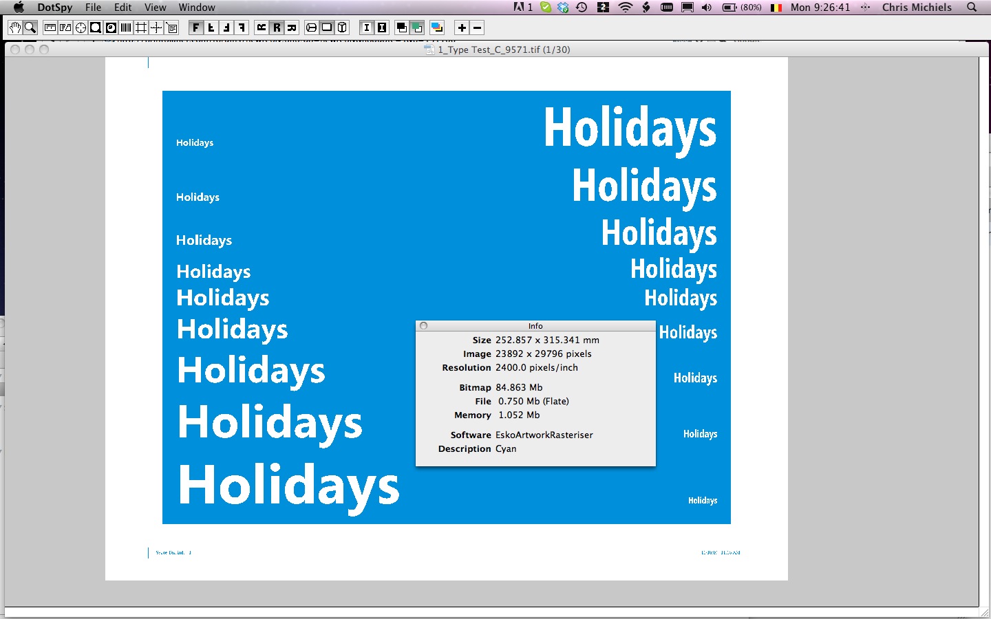

I took the file that you uploaded and ran through our Prinergy system and I got the same results that I did with the original file. The refined pdf looks fine but when you run it through the Prinergy VPS software at 2400 dpi or produce a plate we get the same results with the crossbar on the H at 36, 48 and 60 point.
Another way to see the results is to take the pdf and magnify the H to 2400% and you will then see how it will be produced on the plate.
