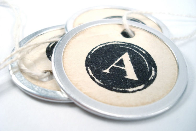

Foiling it would raise a problem with picking the inside of the circle.
On this picture it seems possible:
