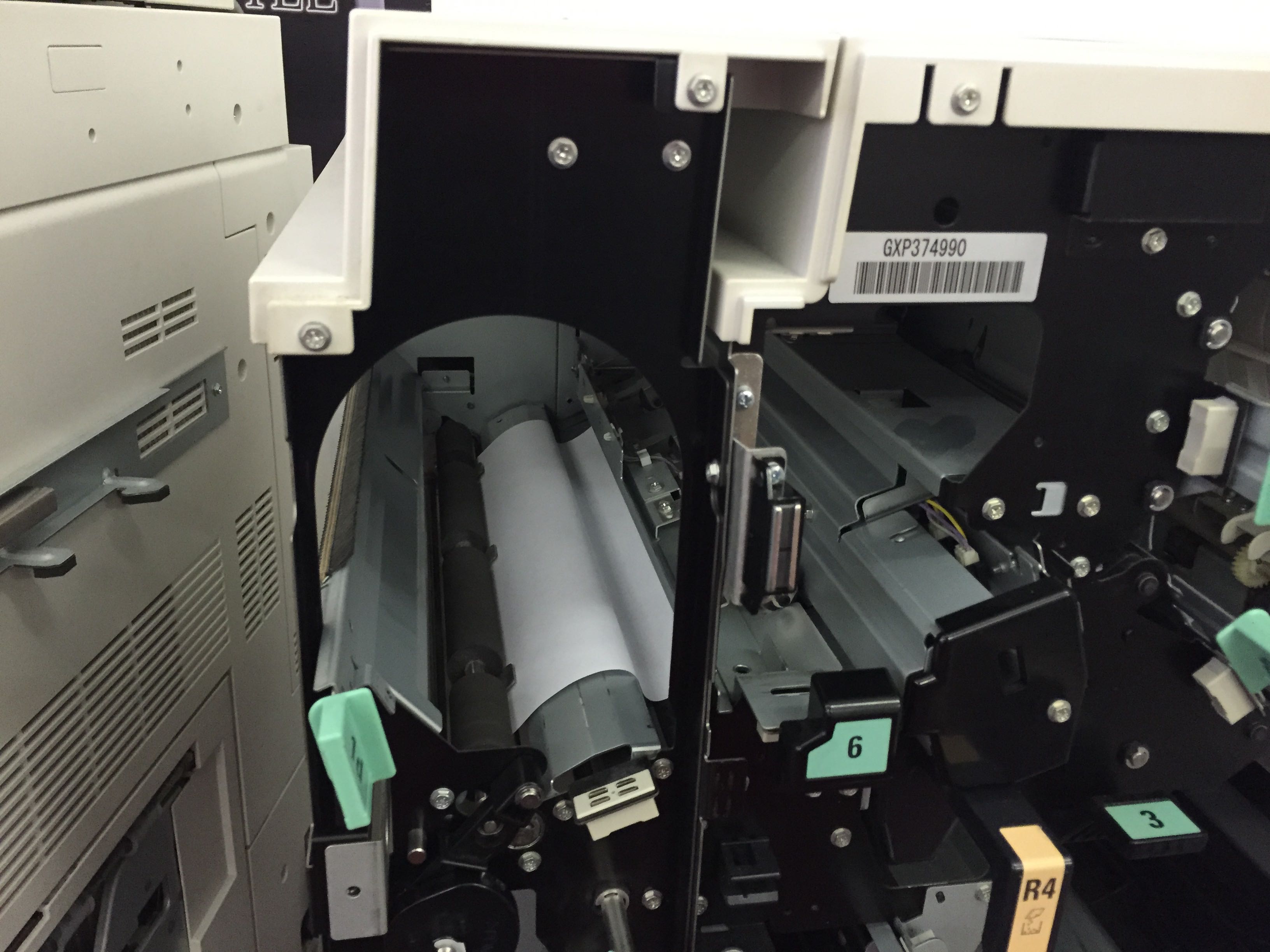

I had a Xerox technician in to fix a jam on my finisher. He can't figure out what the problem is. It's jamming in the first section of the finisher. I printed a few single copies out without a jam and then when I tried printing 500 it jammed on the 1st copy. Any ideas?

The only thing he found was a roller that was slightly off. He tightened it and it worked for about 100 copies. It's jamming on lightweight paper right now. Going to try cardstock.

I only use paper from a package. Have narrowed it down to the clutch. I took off the back cover and saw that only the shaft was moving. Took off the c-clamp and moved the roller a little. Quit jamming for about 1000 copies and just started jamming again. Trying again.
