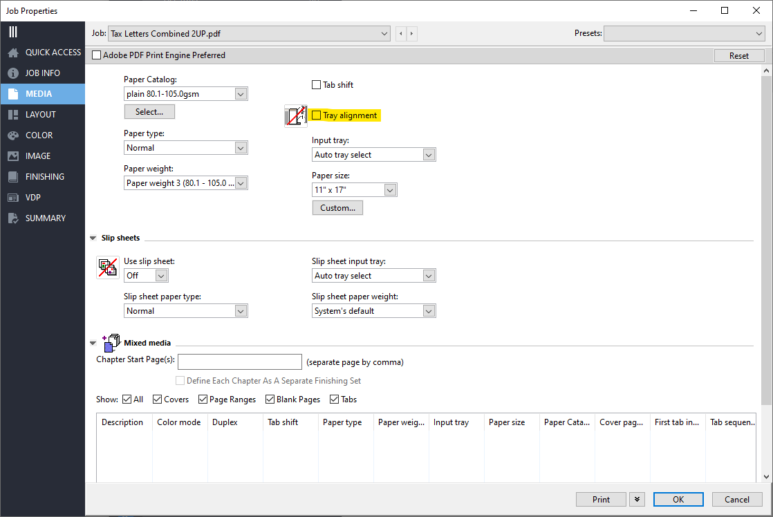

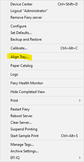

Getting trays to mechanically align with each other requires a super service technician and the alignment of certain planets. IF you are using a Fiery, the Tray Alignment feature (Set up under Server > Align Tray) deals with the skew issue. HOWEVER, it is tray specific. So, if you turn on "tray alignment" in the media settings, you can't autoswitch. It is also sheet size specific and you adjust for simplex or duplex. I'm sure you know that running an alignment sheet and running a job with heavy coverage down one side of a page are not the same. You will learn to tweak the numbers to counter the skew of the sheet you are running. The tray alignment actually changes the rasterized image, so any time you change the settings you will need to remove the current raster image before checking the alignment again. I have countered heavy skew successfully. Caused mostly by the horrible paper we have been getting for the last year. The D125 is a workhorse, but it is expecting good paper. It doesn't have the sophisticated registration system of modern color machines and relies on even roller pressure, which relies on even paper. I am assuming when you refer to printing a line on one side and the other side you are referring to front and back, not left and right.

Yeah, currently we are using Fiery Tray alignment to deal with the registration issues but, as you note, this restricts us to only feeding from a single tray. I definitely was unaware that the raster needs to be removed before printing again. I sure with our techs knew a single thing about this stuff.

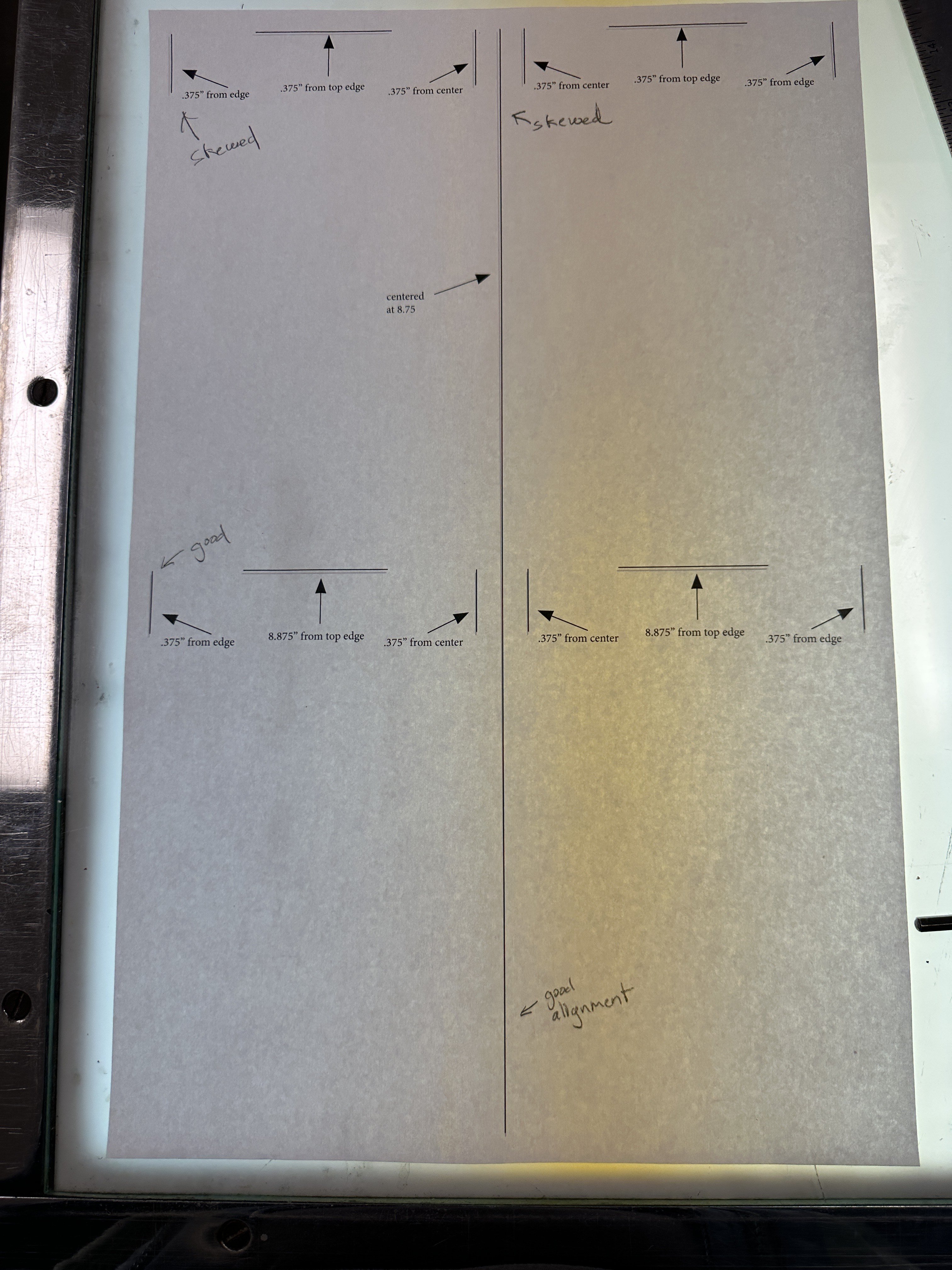

Side 2 every time. Zoom in on this. Same image is printed on both sides. Side 1 is the one facing up. You can see through to the 2nd side. Since this is being auto-duplexed, lead edge of side 1 aligns (attempts to align) to tail edge of side 2.
Oh, also, this is 11x17 paper so for the purposes of registration adjustments that axes are counterintuitive. X-axis runs vertically, Y-axis horizontally. Once we figured out lead edge and axes we've had no problem making adjustments to everything except skew. In this picture you'll notice vertical alignment is a bit off but that can be dialed in fairly easily. Looks like it actually needs a little x-axis de-magnification based on the registration of the horizontal lines at the top and the horizontal lines mid-way down the page.
One other note about the sysadmin level adjustments, on the D125 it is all done on 8.5x11 long-edge feed so the type of issue we are having will appear to be much less extreme. That's one of the disagreements we are having about what is within spec and what isn't. I'm going by the customer expectations document which refers to registration but doesn't specify paper size or orientation. They are going off of some alleged document available to system techs.
Is that as bad as it gets? I agree it isn’t great but at least compared to the j75s I fought with, I can see how this fits in spec. My recollection of Xerox’s registration spec is that it is all based on letter size, and 11x17 spec is double the printed spec. How noticeable is this when finished? At my old job we printed BW books all day and our old Xerox 6180s were certainly much worse than this on a good day. What does it measure as?
Can you fudge the alignment numbers to overcompensate and get it less skewed?

I've been using Fiery Tray Alignment to get it to look that good but as you can see it still doesn't fully fix the problem. Since the ultimate goal of all of this is to be able to auto-switch between two trays, Fiery Tray Alignment isn't going to be an option and one of my big concerns is that if I don't have a good starting point on one of the two trays, getting them to come anywhere close to matching will be extra difficult. I think I have reasonable expectations. I know this machine is meant for speed and not quality. For me, if they can show me that the customer expecations document shows that our current registration is within spec, I'll have to just drop it.
Oh, but yes, I do think I could move it over the split the difference kind of. With that said, at some point along the way the horizontal shift was maxed out on one side. After they did another sysadmin level registration initialization, the tech got it back to having a little room to shift both directions.
And why am I so picky about it? The only thing we print is 5.5x8.5 booklets. We finish offline on a collator/booklet maker. The artwork has left and right margins of .375" and we take a face trim of about .125" so poor registration can become pretty noticeable. Again, I have reasonable expectations. I don't need perfection, just a good starting point and then it can bounce within spec from there.
