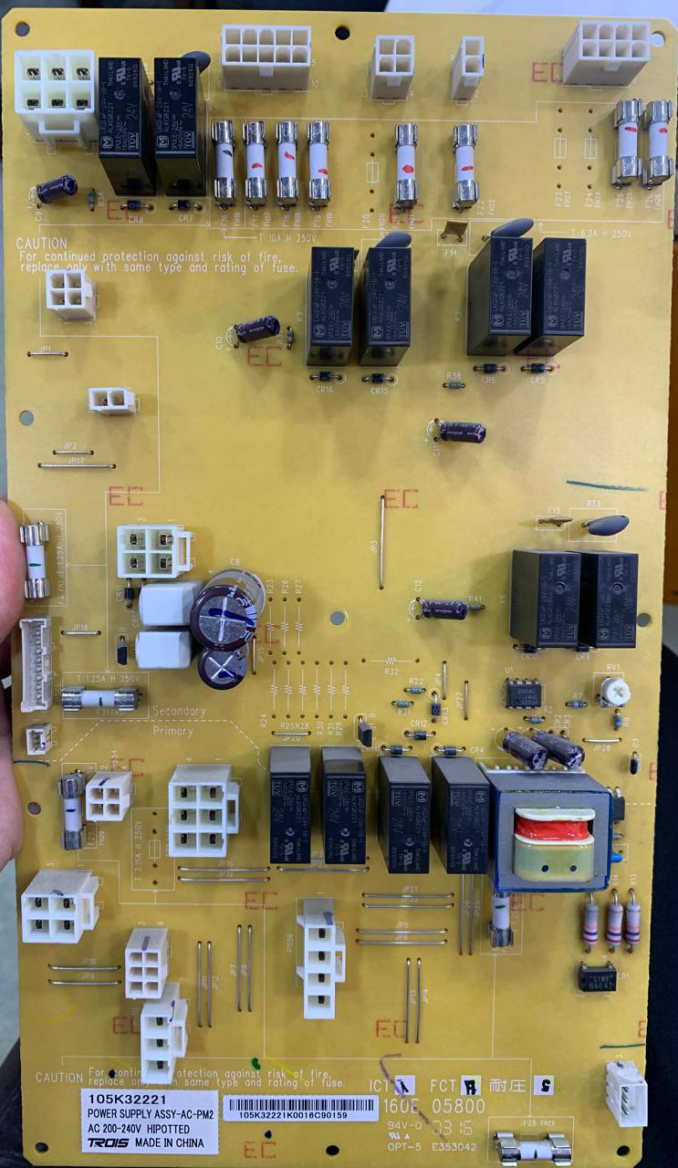

i get error code 42-384 in xerox versant 180
i changed the following
ITB
ITB cleaner
drums
2nd bias
i cleaned the encoder and IBT sensor
I tried to change NVM 741-852 0 to 1
still the same problem
problem solved
AC power supply (105K32222) changed
