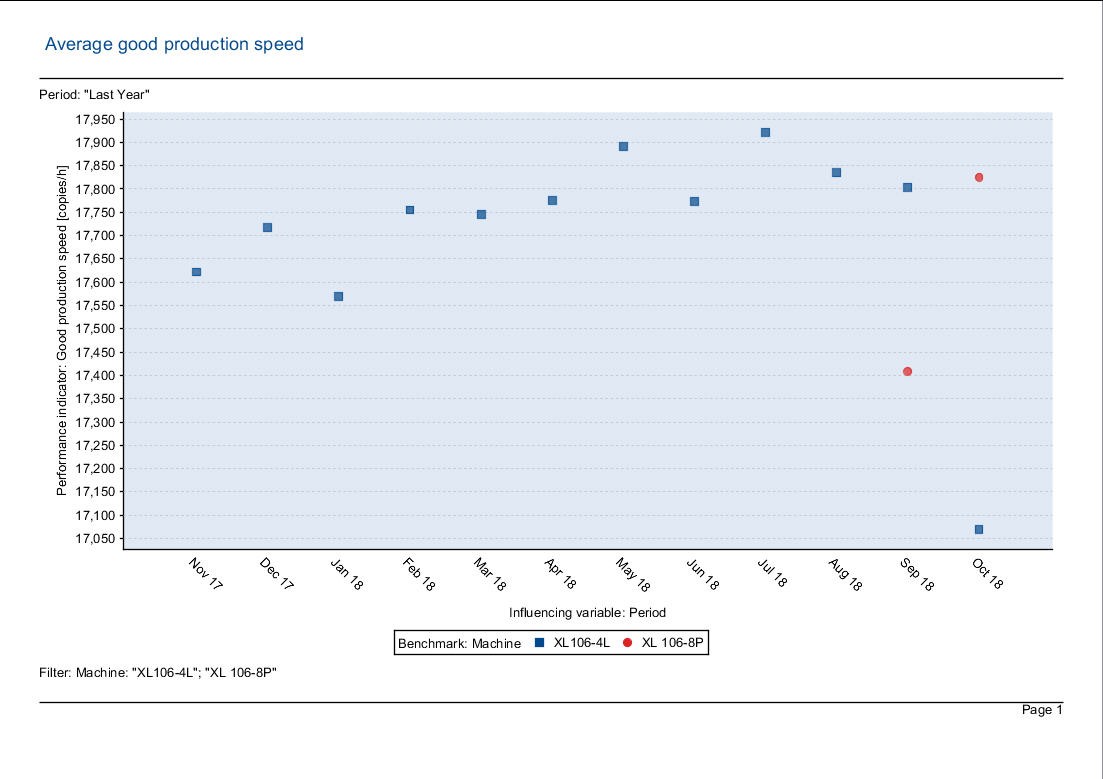

We run 2 Heidelberg XL 106 presses, a 4 color + coater and a 4/4 LED UV with CutStar. The 8 color is 45 days old and has 5.5 million impressions on it, running 3 shifts 5 days a week. The 4 color is 3 years old and has 138 million impressions on it.
Our average run length is under 3,000 sheets. 98% of our impressions are text weight, with 70% of our paper purchases being 70# gloss coated.
We average 3.8 minutes per makeready with an average run speed greater than 17,500 sheets per hour under impression and put 16,250 sheets on the floor every hour.
As for running slower on small orders, that is a mindset tied to older technology. The XL class presses are designed to run at speed and it's easier to control ink/water balance at speed than running slower.

Best post I've seen on this forum in a few months. Concise.
No doubt those numbers are impressive, but if your run lengths truly average around 3000 sheets, then with 3.8 minute make-readies, you could not produce more than approximately 4 of them per hour.
That equates to roughly somewhere between 12,000 and 13000 saleable sheets on the floor, every hour. Still very impressive.
The 16,250 sheets per hour on the floor is for running time.
In 2017 we produced 58 million impressions on our 4 color press. When you divide 58,000,000 sheets by 6,000 hours (roughly 3 shifts) the result is 9,667 sheets per manned hour on the floor. When you start to factor in planned downtime for maintenance, breaks/meals etc. the sheets per operational hour increase.
The point of my original posting was that these presses (at least the Heidelberg XL presses we run) do indeed run at 18,000 sheets per hour, even on light weight paper and short runs.
the 18,000 iph not an issue but it really finds out issues with the consumable set up! inks misting blanket release and register etc
