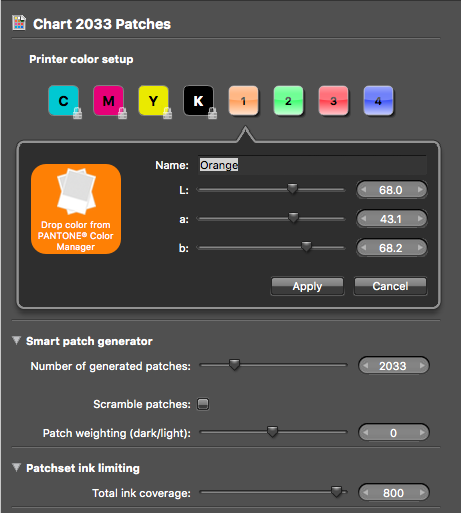

i1Profiler can make profiles for up to 8 separations
