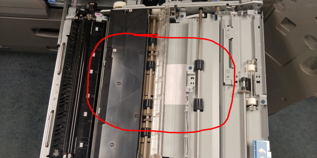

I got a setup similar to yours based on your feedback and have the same issue. I had a really good tech out to fix another issue and while he was on site we spent the good part of half a day just on trying to fix this issue with no resolution. The issue is at the rollers in the picture below, the envelope flap gets slightly skewed up and that is what causes the dogearing the rest of the way. Ricoh support would only say to open the flaps and are not much help.
If anyone has a fix I am all "ears" :)

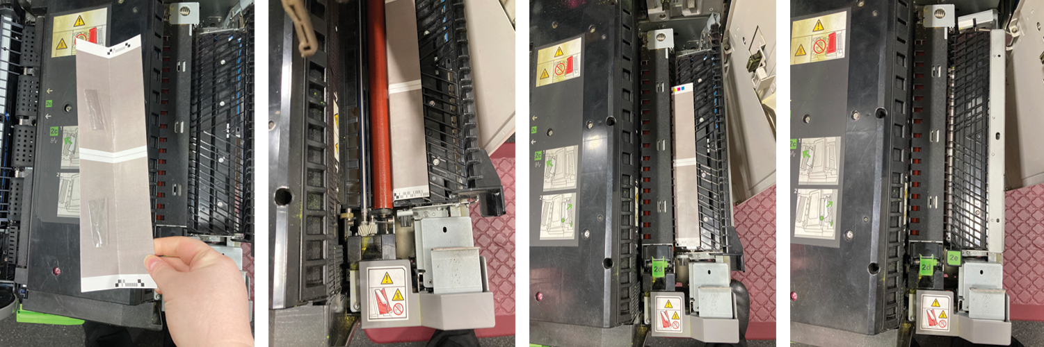

We do put a piece of paper into the machine right after the fuser to prevent it from dogearing the envelopes. We run side-seam #10s and #10 peel and seal envelopes with the flaps closed.

We used packaging tape on our 2100 and it runs envelopes like a champ. :)

Im telling you, it is happening at the rollers in my picture I posted, we dead stopped the machine and found the exact spot. It has been confirmed as an issue but from the techs at Ricoh are saying they will only support flaps out.
Something will need to be done at those rollers to fix the issue.
It still would do it, tried that. It would still do it at that same exact spot. We think it is trying to align the media but it instead is tugging on the flap, if those rollers could be turned off it might not happen?
Which rollers? In the paper tray?
The picture I posted is of the rollers before the paper transfer unit, is it not showing? I circled the area of interest in red.
Good catch! Sorry I missed it but I see what you mean now. Do you know has anyone tried to turn off main scan registration / cross track / cross feed (whatever you want to call it) I could see it do that when it shifts the paper.
Not that I am aware of, how do you do that and I will try it.

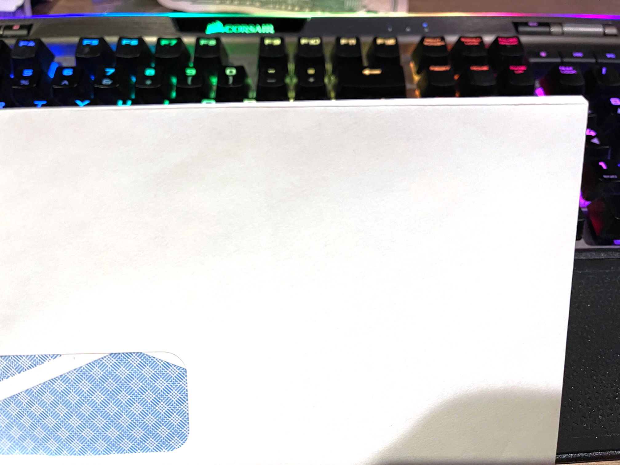

Not that I run either of these machines, but have you tried different envelopes? With our Konica C3080, we ran into an envelope skew issue a couple months back. After some basic troubleshooting with everything looking good - I checked the envelopes for square - they weren't. They were wider at the flap-edge than they were at the bottom edge by almost 1/8". I swapped envelopes and that solved the issue. The press was skew correcting (as it should), but as the narrow feed-edge wasn't square to start with, we ended up with skewed print.
I think you're on to something with the skew adjustment moving the flap and then re-creasing it as it runs through the press. If it was air being introduced into the envelopes, you'd end up with a wrinkling issue and you would also see embossing from the excessive pressure.
The thought also occurs to me that maybe the window has something to do with it - is one side of the envelope dragging under a roller causing the envelope to skew and get refolded? Do you have any of the exact same envelopes without a window that you could test (same die cut/paper/brand)? This comes to mind as we have an Intec CS4000 with basically, a modified Straight Shooter feeder. We prefer to feed long-edge first on that printer, and window envelopes can be a pain due to the varying surface/thickness.
