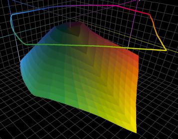

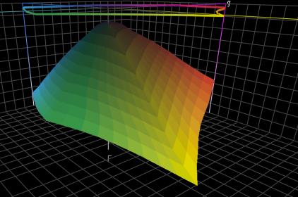

Yeah you have something wrong with your shadow colors/black channel. Compare your profile that has a flat plateau to the SWOP profile that has a defined tip the shadow/black. What device is this profile for and what software are you using to create the profile.
I don't see that in the colorsync utility, unfortunately. (in fact, what I do see looks "pointier" than SWOP)

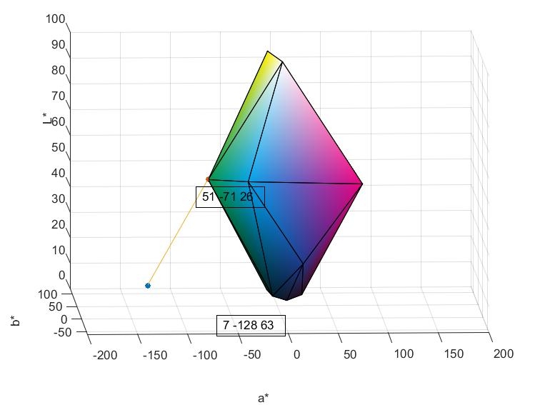

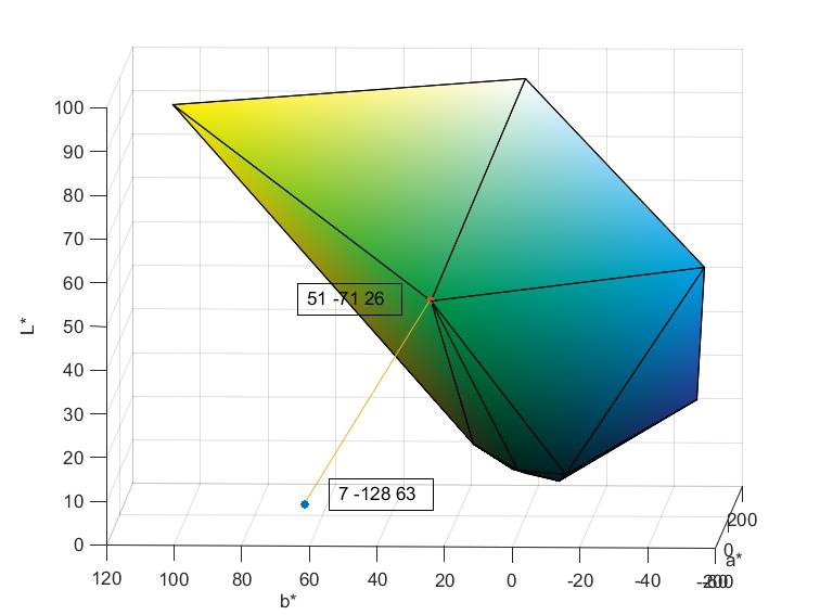

I also used Matlab and here's what i got:
[7 -128 63] -> B2A1 table -> [0.9961 0 1.0000 0] (CMYK displayed in 0 - 1.00 range)
[0.9961 0 1.0000 0] -> A2B1 table -> [51.7632 -71.0078 26.7930]
[51.7632 -71.0078 26.7930] -> B2A1 table -> [0.9821 0.0041 0.9620 0]
From what I see here, the behavior of this profile has less to do with measurements, and more to do with gamut mapping. When the profile was calculated, the non-existing (out of gamut) [7 -128 63] L*a*b* value was mapped to [51.7632 -71.0078 26.7930] L*a*b* value which does exist (inside or at the gamut boundary) for this process.
I've never inspected other profiles you mentioned, but what happened with this profile does not surprise me much for M channel. I wouldn't expect to find all three primaries (CMY) at the gamut boundary since it is gamut boundary... It is normally determined by primary and secondary colors, while tertiary colors fill the inside volume.
What is strange, however, is that such dark color L*=7 was mapped to such relatively light color L*=51.76. I'd expect it to get mapped to some darker color which uses some K.
I can't explain fully what's going on here, but I'm convinced it has to with how the profile creation software performs gamut mapping.
With simplified gamut visualization, your case would look something like in the below images.
Click image for larger version  Name:	gam1.jpg Views:	2 Size:	106.2 KB ID:	265018Click image for larger version  Name:	gam2.jpg Views:	2 Size:	93.0 KB ID:	265020

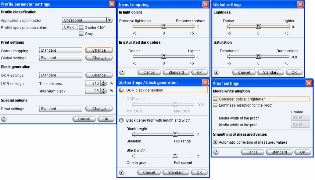

I have recreated more profiles that yielded same results.
Attached are the parameters I can adjust.
This program has always done well for me, but I'm at a loss as to why it's removing the contaminant colors (M & K).
Maybe it just doesn't do well with conversions from Lab, which is definitely strange, but rarely do we convert from Lab. So....IDK.

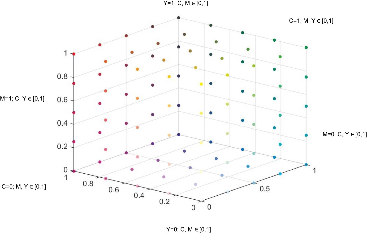

As I said in earlier post, for Colorimetric intent, out-of-gamut colors are mapped to colors at the gamut boundary. All colors at the boundary are primary or secondary (+K for darker ones). That's why M=0. You won't find tertiary colors (C, M and Y all greater than zero) at the boundary.
I'm not sure whether the choice of gamut mapping algorithm (GMA, you have it in options) will affect Colorimetric intent (or only Perceptual), but it's worth a shot. If it doesn't then I'd repeat what Jason said, the difference is in the profile creation software. Two apps apply different GMAs when calculating Colorimetric intent.
Just to correct my statement. There are some tertiary colors at the boundary, but only a limited set. Gamut boundary colors are those for which one of the channels equals either 0 or 1, and others vary in continuous [0, 1] range. Setting one channel to 0 or 1 restricts colors to faces (boundaries) of CMY cube or CMYK hypercube. See image.
