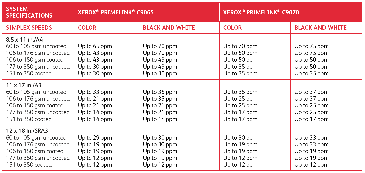

No one did. But since they slow down, they do so for a reason.
For example, the Konica C368 (an old copier) slows down at anything above 90 gsm if I recall, to roughly half speed.
Even the older Xerox Primelink C9070 will not slow down to half speed for stocks over 100gsm. Take a look at this chart. Personally I would have no issue running a 120gsm uncoated stock as 100gsm if the 10 pages per minute on the A3 was a big deal. Fusing is the issue, and at worst it will show in your output but the difference between 105gms and 120gsm is not significant.

I hope office machines get their speeds published at higher grammages, like the numbers you showed above.
