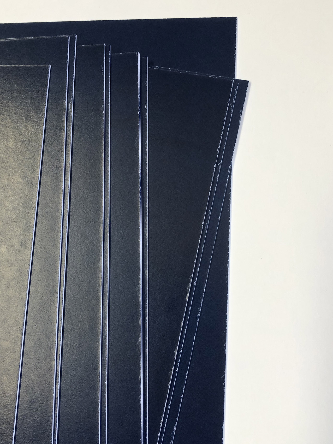

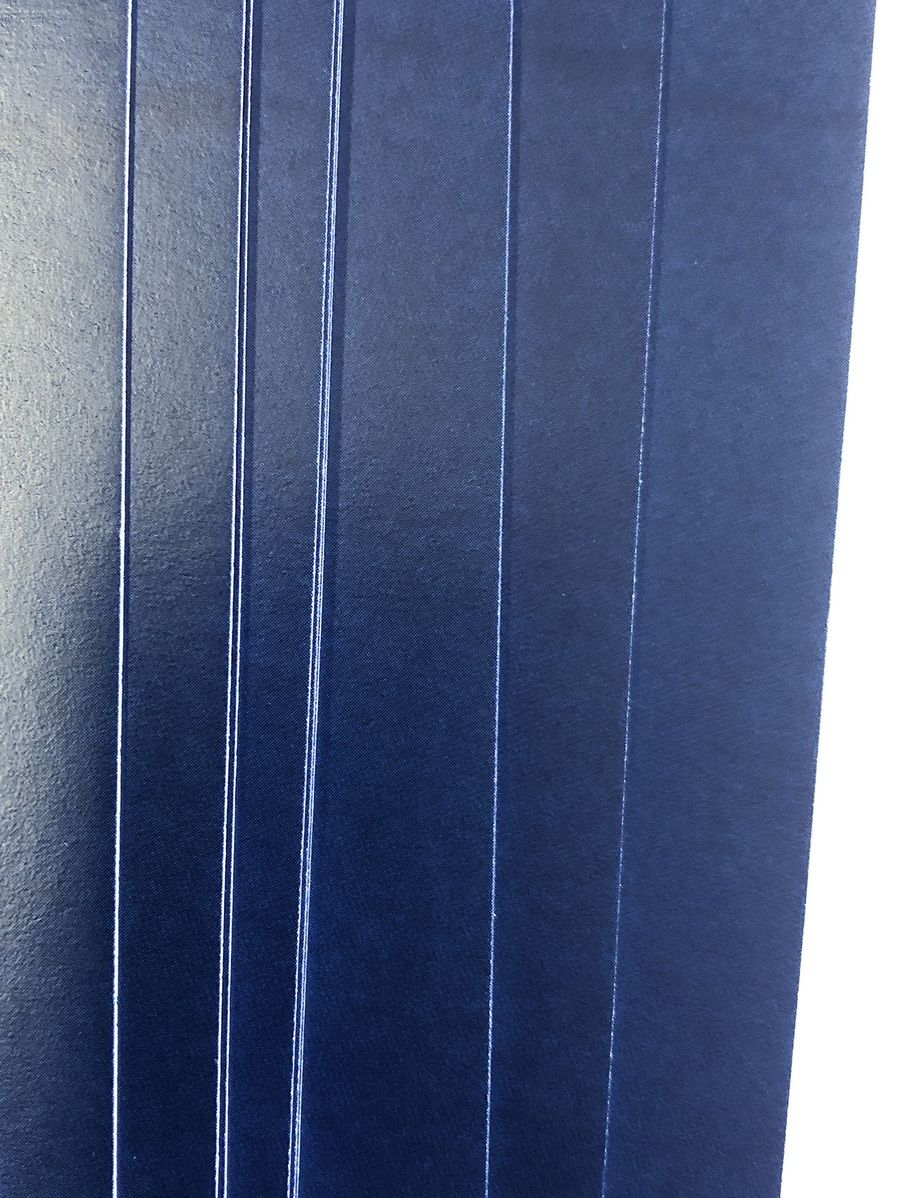

I've printed a menu on my Xerox Versant 80 toner based digital press which is 2 sheets of 350gsm Silk.
Both sheets have a solid blue background and they are then duplex glued back to back and after 24 hours I guillotine to A5.
Front side looks excellent with nice clean edges but the reverse side is rough with flaking edges because I'm cutting against the toner.
I understand that laminating would cure the problem but does anyone have any solutions without laminating.
I've tried the following but still to luck:
1 - Printing on Silk, Gloss & Uncoated
2 - New blade on the guillotine
3 - Guillotine with the good edge facing outside of the blade instead of inside.
4 - Lots of waste card above and below the print job when cutting on the guillotine.
See attached pics of the front and back

350 gsm is at the very upper limit of the v80's paper weight range. I would think with the combination of heavy toner coverage and paper weight that the fusing would have to be performing at it's very best to get you through this cutting. Have you tested with a lighter weight stock? Try spraying silicone on the blade that touches the finished edge of your sheets.
Good shout!!! I've tried the silicone spray with the new blade but I might try gluing 2 printed sheets of 200gsm to a 350gsm centre sheet with a hotter fuser and slower speed. Thanks
@sidneykidney I normally find your option (4) - padding with waste card - sorts this problem.
Is it grain related in any way? i.e. is the effect better/worse on the sides parallel with and against the grain
I don't have a solution but I was wondering if putting the engine in skip pitch mode would give you a little better toner adhesion. If it's enabled on your 80 then you can use NVM 740 492 - 0 is off, 1 is on. You need to restart the press after entering the NVM for it to take effect. It will run at half speed.
It could be that the problem is there's too much "give" on your edges. The stack is compressing slightly when you're cutting so your sheets are bending slightly at the edges during cutting which cracks the toner.
This is going to be a problem with anything with a core that gets too thick.
Figuring out how to "stiffen" up your cutting stack might help.
Things I would try:
1) Cut twice. Cut once about halfway between where you need it to be and your final cut. This can make your second cut firmer since the edge of the stack is perfectly supported by the sheets underneath it (all sheets are even).
2) Smaller stacks so there's less compression on the entire stack.
3) A piece of solid chipboard on the bottom of your stack.
4) Make sure your cutting stick is fresh so there's no give in the groove that forms there.
5) Craziest Idea - Crease the spot you're going to cut on the sheet before gluing. No idea if this would work but if we're trying random things. Theoretically this would compress that spot so that it can't "give" during cutting.
Things I would try:

I don’t have cracking issues when cutting duplexed 350 gsm stock printed on my 280, so my guess would be toner adhesion or as others have suggested a gap that’s created between the sheets from the film thickness of the glue. Different glue film thickness or maybe some type of extra clamping pressure before cutting.

I've just tried putting a 305gsm Uncoated sheet with Solid Black through the guillotine and it's come out very clean.
This now leads me to thinking that as mentioned by 'tngcas' and 'TJ Printer', there is too much give in between the glued sheets.
I'm going to try printed the 2 sides on thinner material with a heavier fuser temperature and glueing to a centre sheet.
