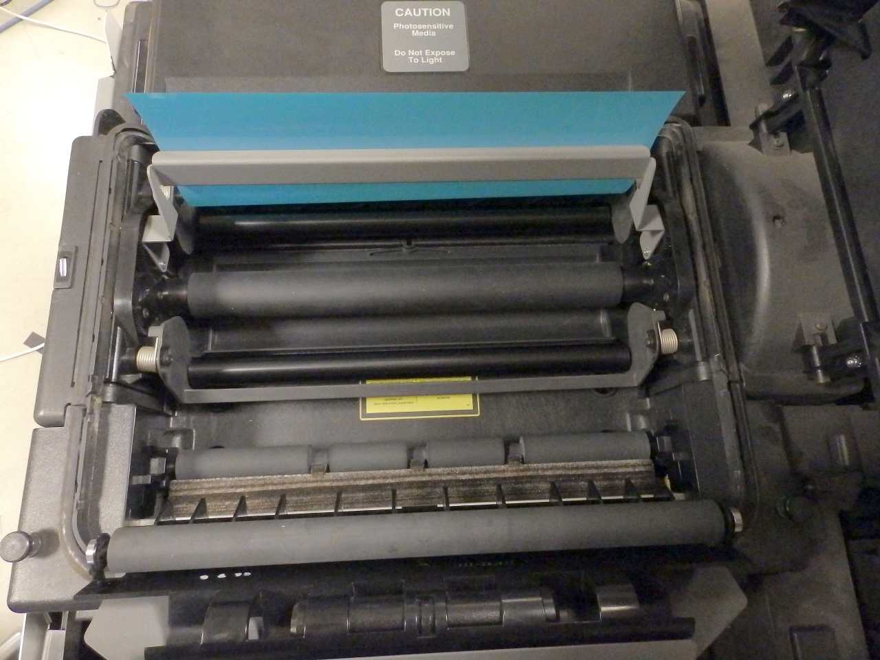

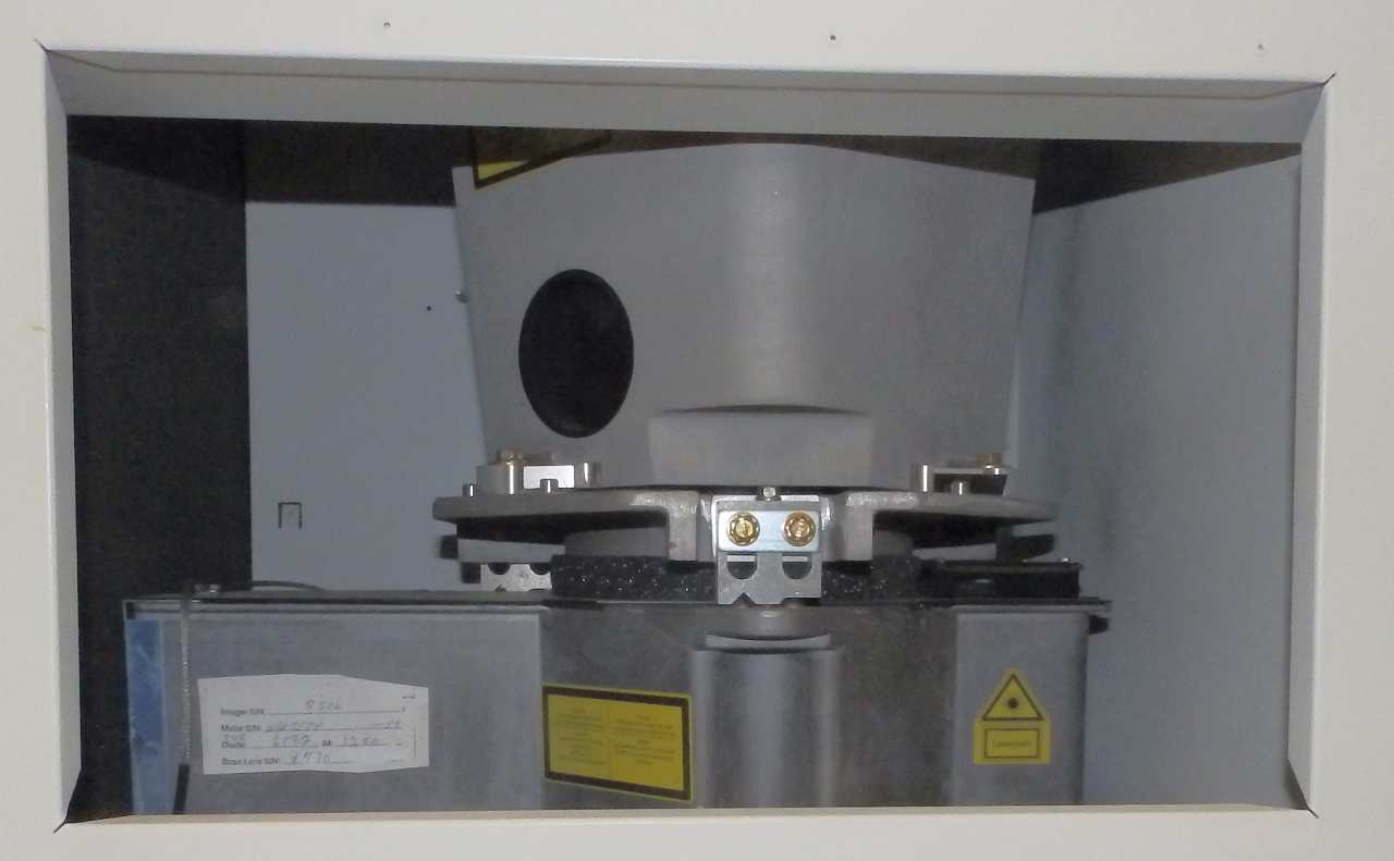

I am sorry to trouble you again, but I am afraid to disassembly something wrong and destroy the machine :-( From top side, there seems to be nothing to easy unscrew. When I removed front cover, I see something like big aluminium tube inside and probably laser module mounted on it at the bottom. Should I unscrew this block with yellow labels from the tube and remove? Is it necessary to align or setup module when I will mount it back?
