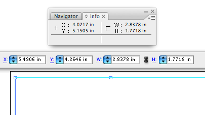

I can't believe you actually wrote that Greg. What prehistoric version of Illustrator are you using??? See attached, which was captured after the Ai file was closed and reopened.
Al

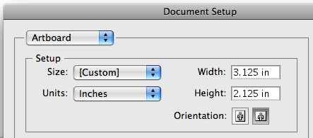

Here is a screen capture of the Artboard dialogue. Again, after saving, closing, and reopening.

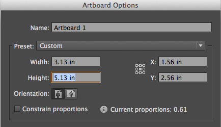

I meant to say it doesn't support 3 decimal points for Artboards (as far as I can tell). I seem to get a different result from you. Tested on CS4 and CS6 on Mac. It allows 3 decimal points for objects, but the Artboard options seem to only allow 2.
Try going to File/New and creating a document 3.125 x 5.125. I can't....it rounds it up to 3.13 x 5.13.
If I double click the artboard tool to modify my artboard size, same behavior.
How were you getting the 3 decimal point values?
I fired up the Mac which has the 5.5 suite and it did exactly what Greg described above, artboard rounds to second decimal, 3 for objects.
The screen captures I posted were done from Illustrator CS3 Mac. I was unaware of a new "improved" 2 decimal place limitation in the newer versions.
