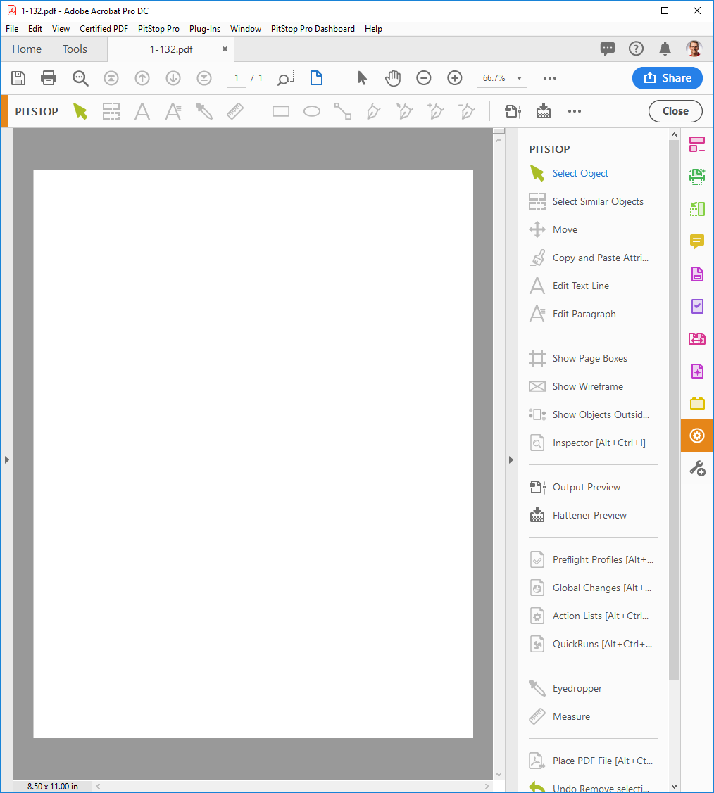

pitstop is my goto "tool", so i would love if Acrobat opened like the attached photo. AND when every you revert, pitstop toolbar closes, which is a pain.
That might be doable. The method I prefer is to put all of the commonly used Pitstop tools in the "quick tools" toolbar (View > Show/Hide > Toolbar Items > Show Quick Tools/Customize Quick Tools...). I have about 16 things there and rarely need to open the tool panes. I still miss the older versions of Acrobat with toolbars that weren't glued to the document window. In the good old days, I could devote most of the primary monitor to the document and have most everything I needed a click away on an adjacent monitor.
