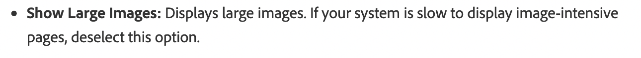

Try turning this off.
Thanks for the replies prepressdork and oxburger. I narrowed it down a bit more, so if I turn off the Output Preview it doesn't happen. So not to do with either Pitstop nor the Prinergy PlugIns.
These are not complicated images, the SBOD is apperaring with the simplest of pdfs but turning off the Page Display oxburger suggestion made no difference.
