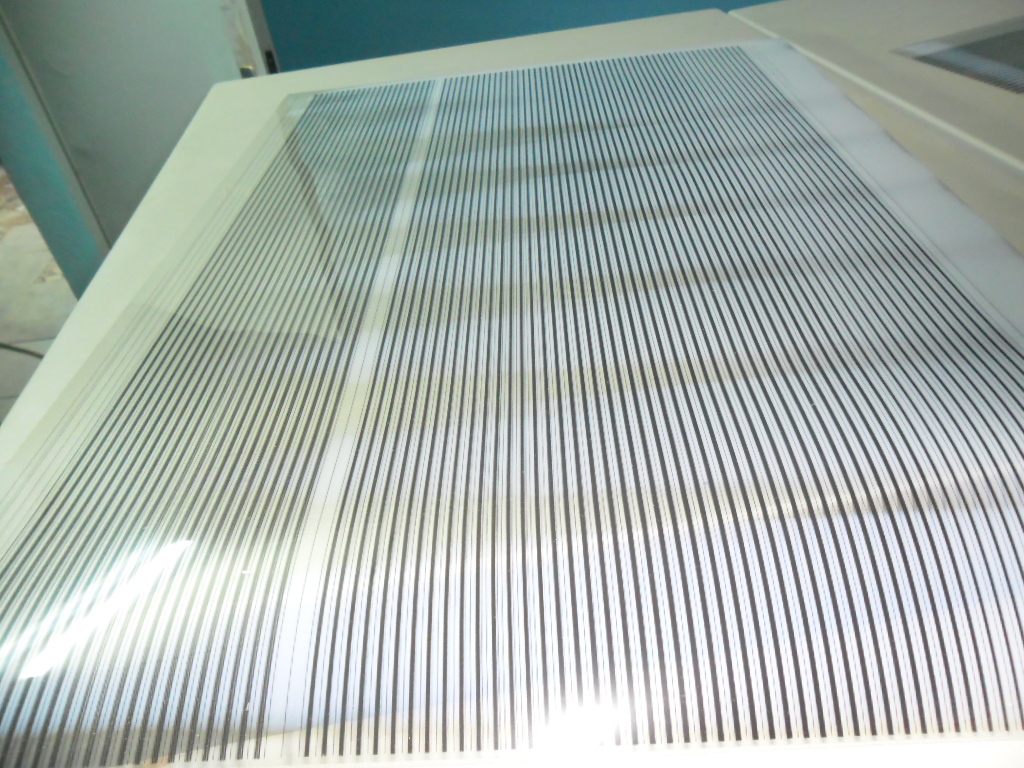

Hi, I try to help a friend who obtain strange lines when he output an internal test with his Avantra. (picture attached)
I have inspected his machine and the DEC board seems to been changed recently.
The Avantra boot without problems but impossible to output a job or a simple test.

First output an exposure test from the machine itself and let me know if you will get the same result.If not and the exposure test is O.K then suspect APIS board , and the Rip computer. If the result is the same DEC or Carriage board might be defected, but check the earth to the machine before jumping to conclusion.
Hope this will help!
Thanks for your reply Armya.
The picture attached is a film processed from an internal exposure test.
We have checked the earth with an electrician and it is very good.
I suspect DEC board but I need a confirmation.

Question: You stated that Dec bd was replaced. Have you had this problem ever since this new dec bd has been installed? Have you reloaded any software?
The software that is loaded on this Dec bd is not correct. DSP software is wrong. Correct software should be A6.0C. Need to know what the part number is on the

Yes, DSPA60C.hex is correct. Loading correct software my fix problem. I don't understand, why you did not get some sort of error on boot up. If loading correct software doesn't work, I would get a new DEC bd.
