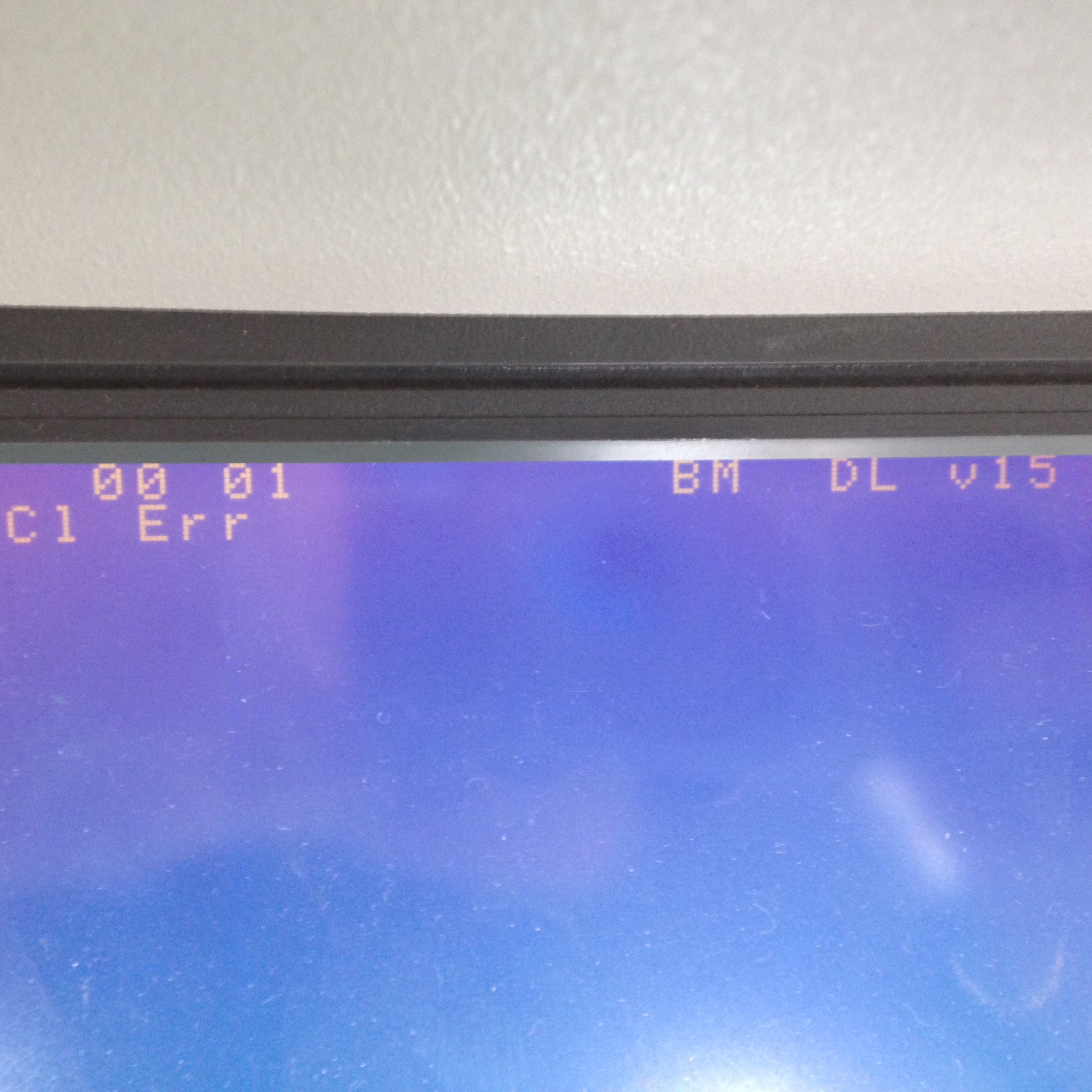

We have a Avantra 25 that has been having strange OCP issues since we moved into our new building.
The OCP keeps loosing its firmware but we could always reflash the OCP hex and get it operational again.
(We have strange power issues in our new building.)
Our art department powers the Avantra down at night before they leave and boot it back up in the morning and get the blank screen on the LCD.
Normally, we just fire up Avdiag, flashrom, Prog OCP, use the ocp0701.hex and tada! The screen fires up after a reboot.
However, today a new issue came up.
The LCD/OCP had a strange error on boot up: "00 01 BM DL v15" & "Cl Err" (see attached image)
I retried the normal OCP flashing procedure and immediately received a new error "APIS Command Error: Illegal Command". (Avdiag showed "Erasing 00:00:00" right before the error appeared.)
After pressing a key, it showed another screen "Command: PROG_OCP".
I then rebooted the Avantra and restarted Avdiag.
To my surprise, the DEC and DSP firmware were gone!
Avdiag displayed 0.0 for DEC/DSP firmware and a new status: Blank FlashRom...
I reflashed the DEC and DSP/Corr table hex files with our backups and rebooted.
The firmware was retained (*whew*).
I then tried flashing the OCP again and received the same errors.
The DEC and DSP firmware were also gone again!
Has anyone else experienced this?
Does that sound like the OCP is dead?
The sticker on the side of the OCP reads: 2525-520 REV E & 209291-501 REV B2
Luckily we have an older Avantra 1000 that I brought back from the grave to get production working again.
Looking for some expertise or suggestions...
Anyone have any ideas?
Thanks,
J
