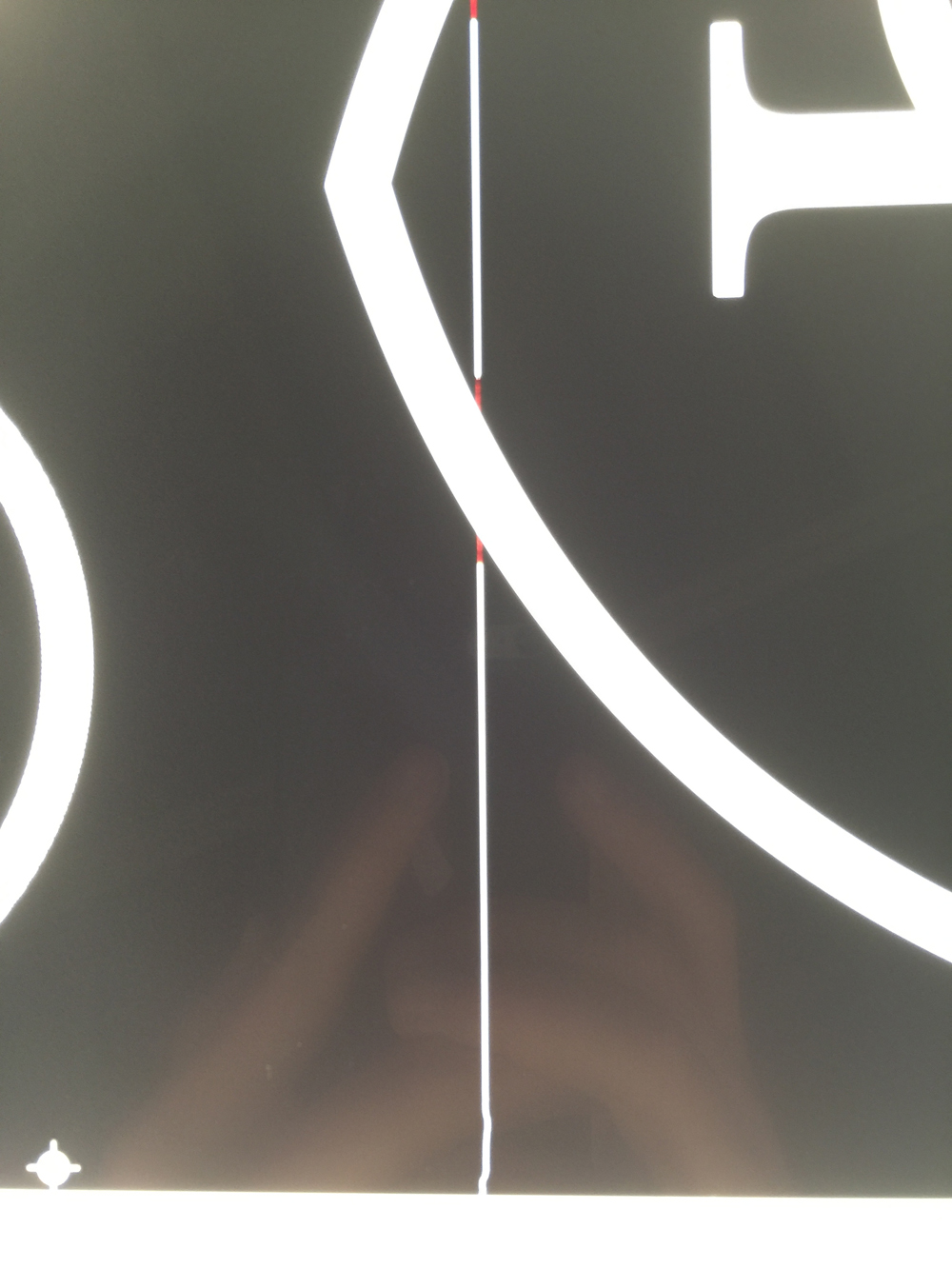

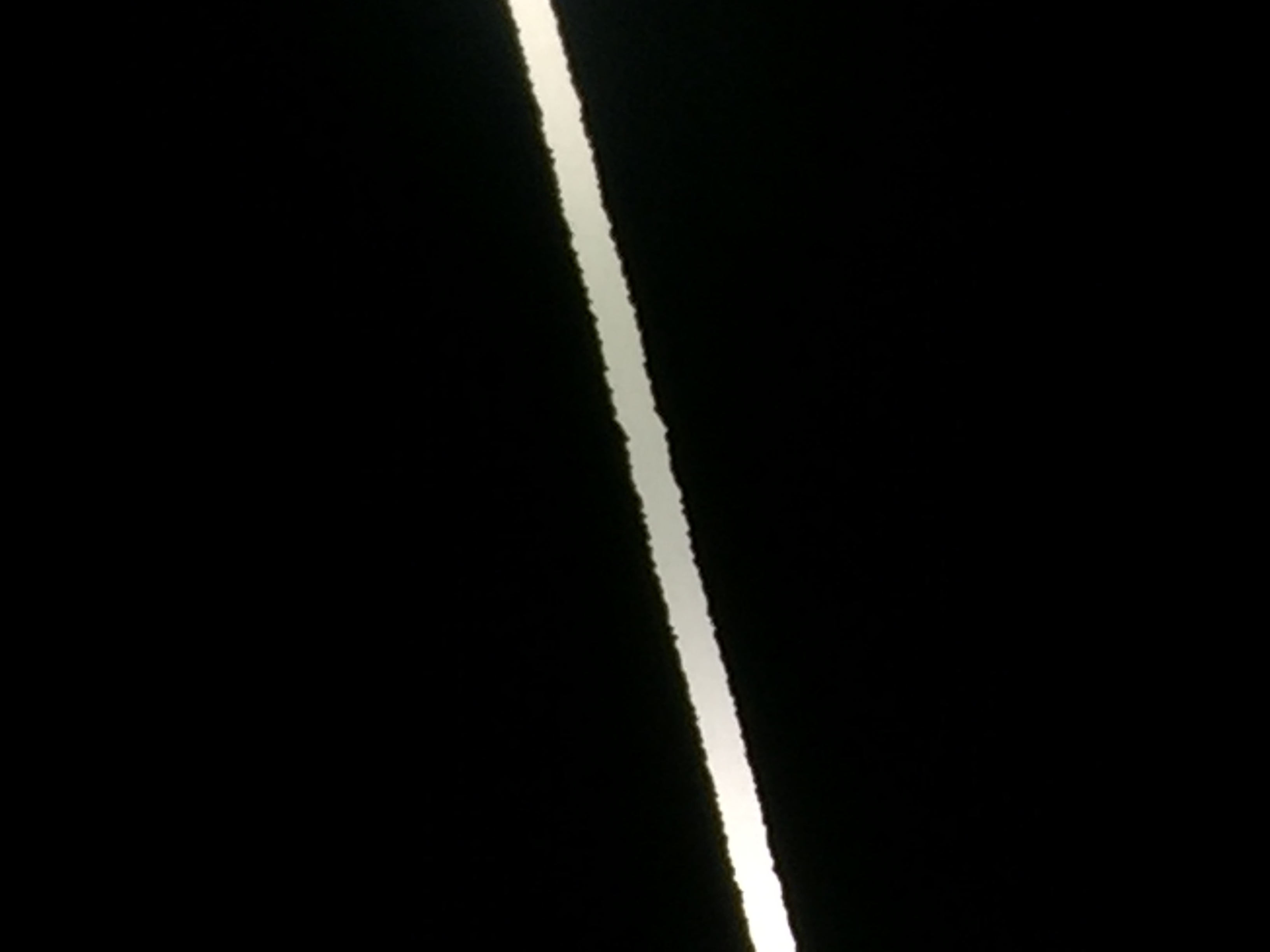

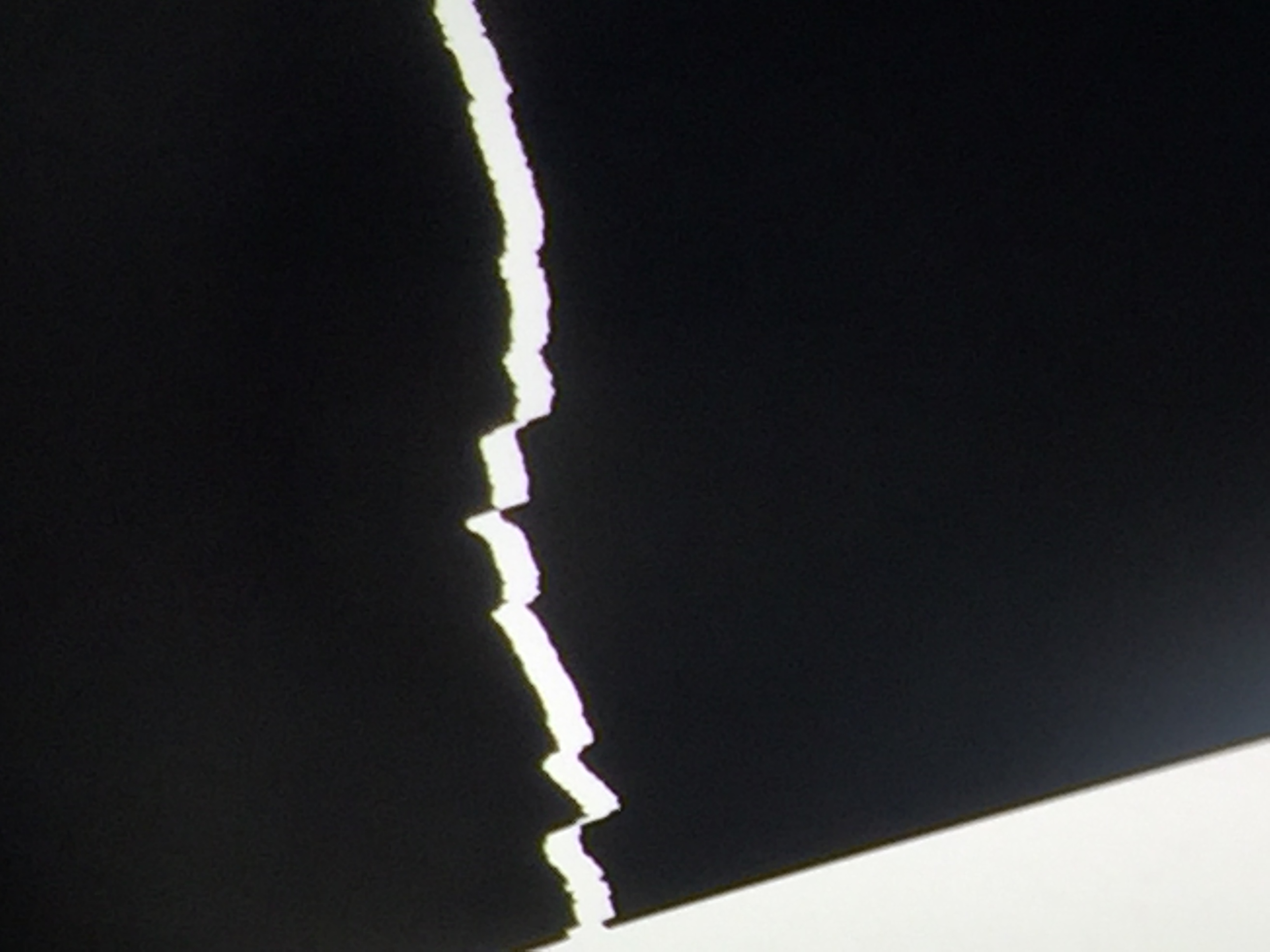

We are using an avantra 44s and just recently there is a line imaged in the film. See attached photos. it is fairly straight but under magnification it appears to be wavy and gets erratic at the end of the film. It is not a scratch there is no mark on the emulsion of the film. Any ideas what would be causing this?

Since the line is clear (non imaged), then the laser ray is blocked or deflected somewhere along its' path.
I would start by cleaning all reflecting surfaces along the light path.
Solved thanks you rock Repro_pro!!!! I removed the brushes that enclose the laser, and on one of the brushes was a 2.5" long hair. This hair presumably from the brush itself, was being dragged across the film and blocking the laser beam hitting the film causing the line. Now we have some pinholes in the film due to the opening up drum unit. Hopefully the vacuum system will get rid of the dust eventually. But at least there is no line on the film.
