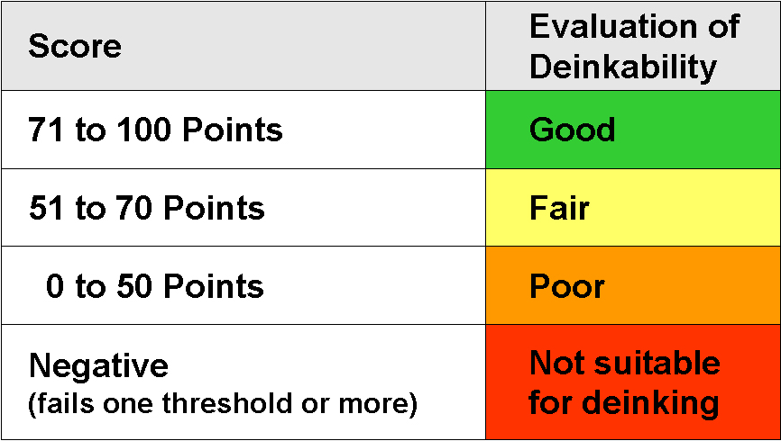

So, you've never been to the factory, never seen a single print, don't know how the machines and the process work, never seen the deinking score the prints received, but you somehow "know" everything.
Mr.Schnitzel were the deinking test performed by INGEDE?

Sometimes the quickest way to find an answer is to ask INGEDE directly. So I emailed them and received the following response from Axel Fischer of INGEDE.
Dear ?????
Probably Schnitzel (who is from Rehovot, Israel, according to his profile) hasn’t seen the deinking scores either? You almost could read that as well?
We did not perform any tests yet, we were not given any samples yet, we offered cooperation and early tests under NDA already at Drupa 2012 and many times after but Landa did not come back on that offer.
So I assume that the Landa technology will be a thinner Indigo film, some plastic film transferred from a carrier to the paper? There seem to be no nano ink particles but they together form a layer that needs a certain grade of cohesion to be transferrable from the carrier to the paper?
So if all these assumptions are right, there are chances that we will have similar problems as with Indigo (which is currently the digital printing technology causing by far the biggest problems in paper recycling): large, thin, flexible chunks of plastic that are difficult to remove from the recycled pulp in the deinking process. A lamination rather than a printing technology. And despite all of HP’s greenwashing, it is NOT deinkable.
And I think if it was different, the Landa folks would have come up to us and given us samples to have this feature clear. I thought Benny Landa was smart enough not to run into the same trouble that Indigo has now, but that has been developed in times when sustainability was not an issue.
