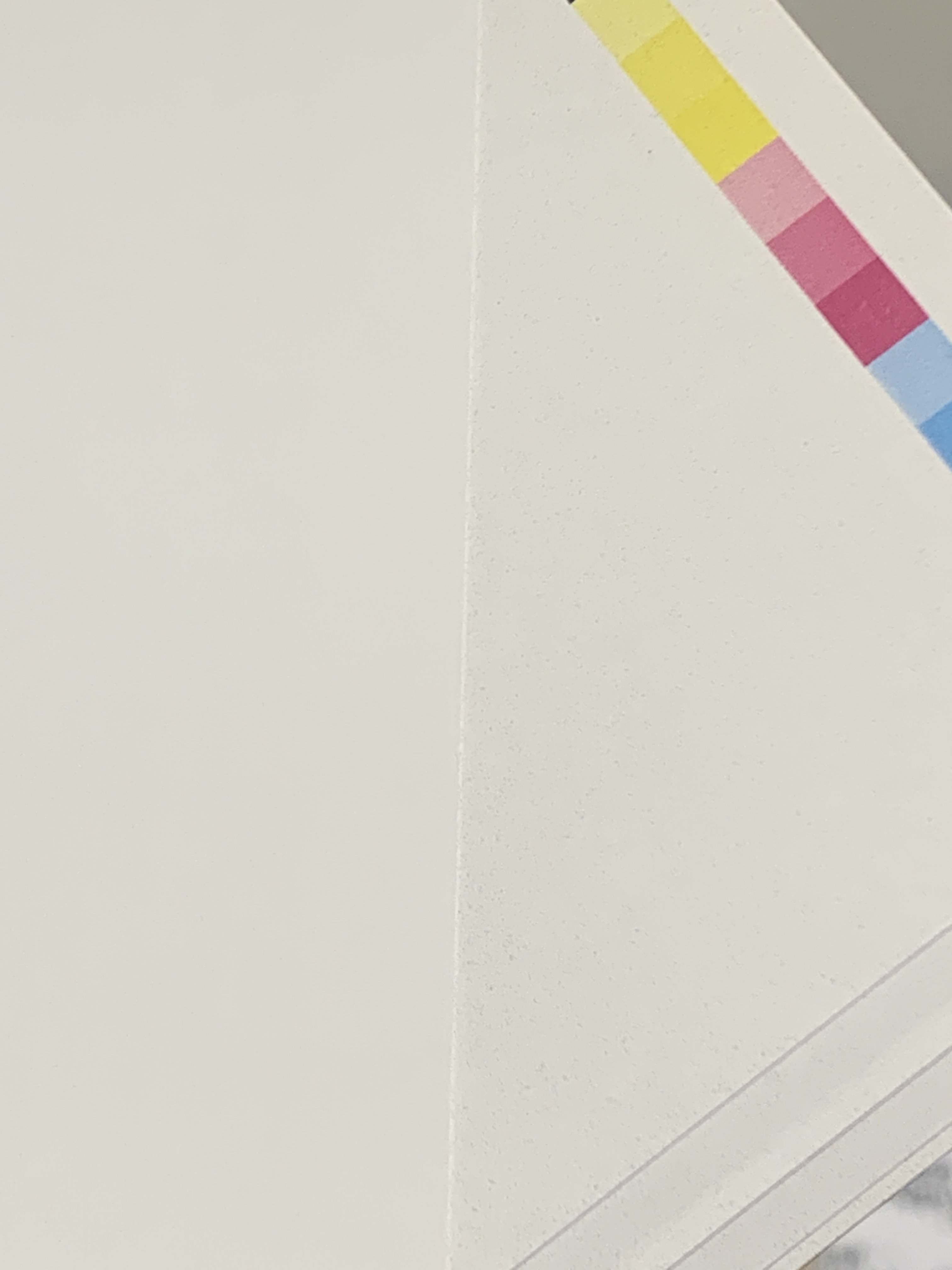

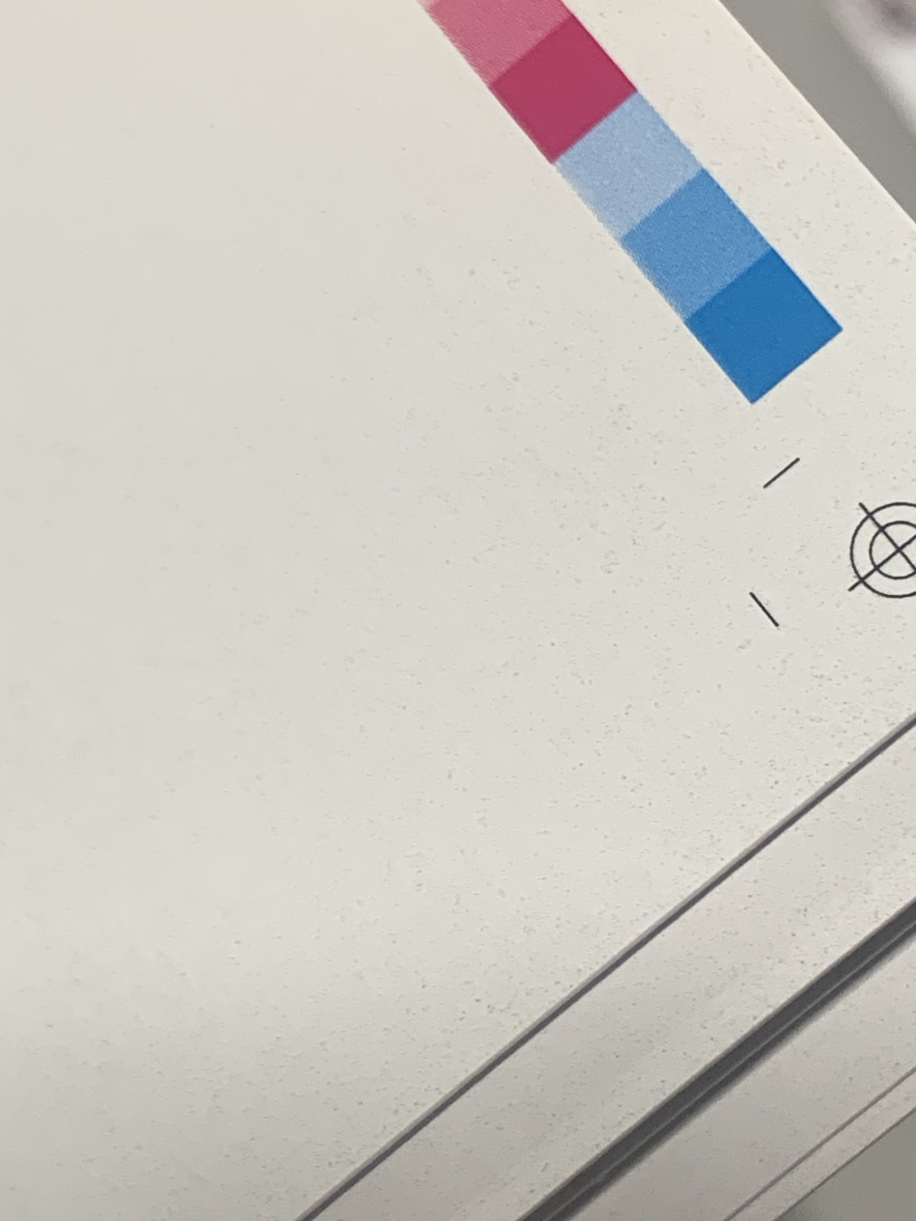

Not come across this before but printed a load of 350gsm card today with a white background and noticed a grey hue on the white areas. When I looked closer it’s like black specks of toner all over the sheet.
Is this likely to be bad developer or is there somewhere I can clean to clear this up?
Machine is a Xerox Versant 80.
Thanks in advance

It could also be a faulty toner. I've encountered this before here.
I’ve only noticed it today and the toner is half empty. Could still be possible, or possible that I’ve not spotted it before now (we do a lot of full coverage prints).
If you switch the black drum with another color, do the specks still show up as black or do they follow it to the other color?
I’ve seen this before with Xerox printers but only when a black drum actually gets used to 100% of its life. Happened maybe half a dozen times in the 4 years we had our versants.
