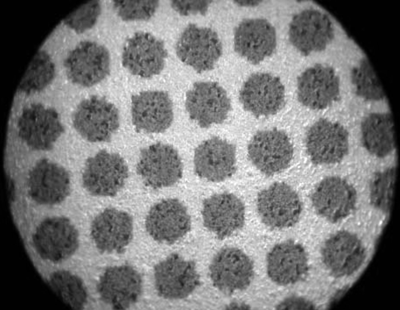

Look at the halftone dots on the plate. They'll look something like this:

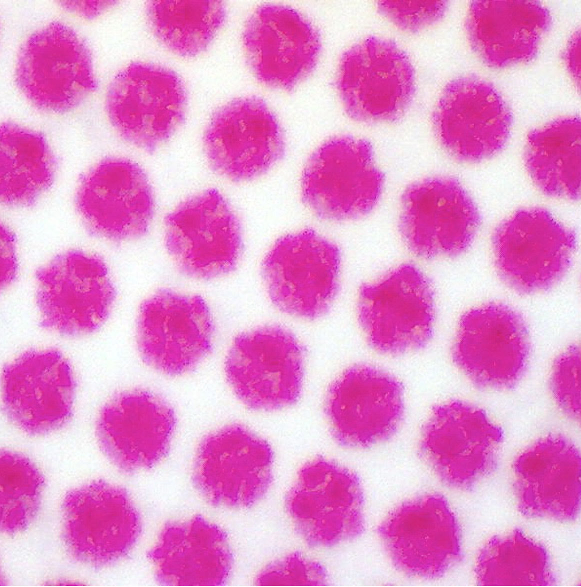

The job of the press is to reproduce the dots on the plate on the press sheet. Properly done the result looks something like this:
Note that the dots are evenly dense across their surface and that the perimeter of the dots are soft/fuzzy. Remember that the fountain solution is a solvent. That softness is caused in part because of the fountain solution eating the edges of the dots - but doesn't affect the solidness (ink film thiskness). The slight edge softness is normal. The ink lay down across the solids is because the ink formulation for that press condition is good. Ink is designed to absorb/emulsify a few molecules of fountain solution.

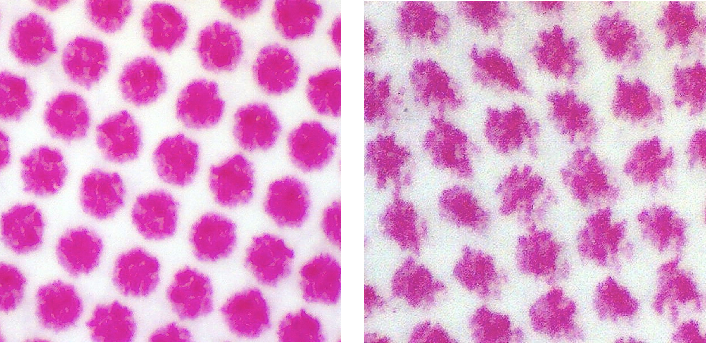

Now compare those dots to those on the right:
]When over-emulsion occurs the fountain solution overcomes the ink resulting in one or more of these symptom: lighter dots (lower apparent dot gain), very soft and ill defined dot perimeters, and ink voids in the solids.
