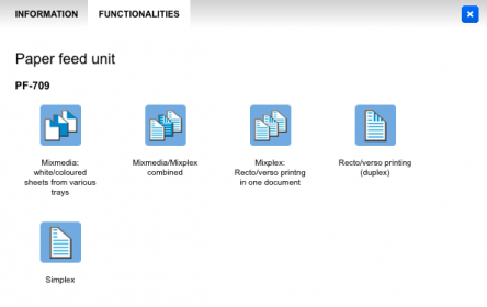

We recently purchase konica 1100 pro B/W machine with PF 709 feeder unit. On feeder unit brochure, they say that it can do mix media, mixplex...
But i can't find how? when asking reseller, they say machine can't do it, so why on brochure catalogue KM say it can do it with PF709 unit installed?

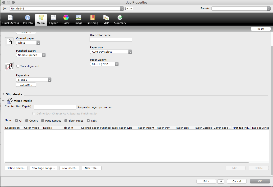

I have a PF 709 on a KM c1100 and I run NCR as well. You can run collated NCR, this is fastest, or you can run the different colors out of the 3 drawers. I have attached an image of where I setup the separate drawers in the fiery.
HI pacart...he has a Pro 1100 which is a b/w printer and it doesn't have a Fiery...not the C1100. But yes, I agree to buy pre-collated NCR is always best!
