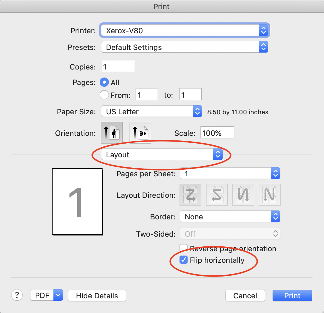

If it's not in command workstation you could look at the postscript print driver.
Install the Postscript driver for your particular Fiery and file/print your PDF from Acrobat. You'll find the "Mirror" option in the layout section.

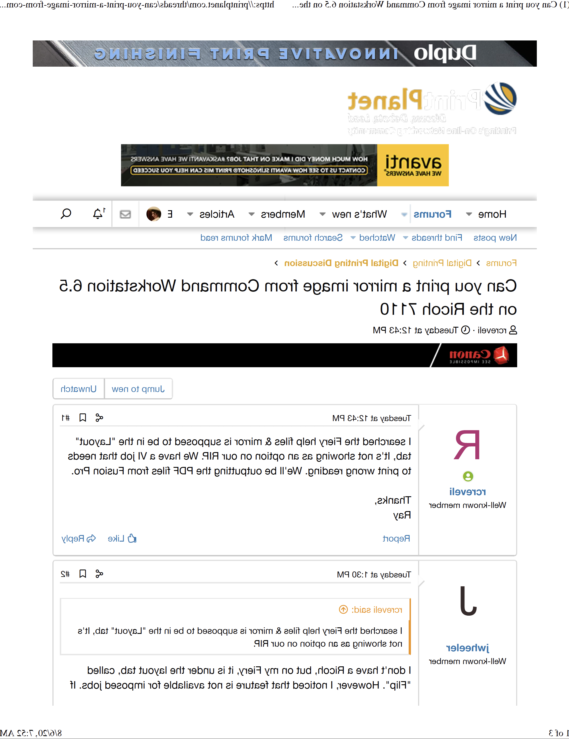

That works. Here are some screen shots from a mac, you can print from any program, and do it, I can't test on a PC right now.
