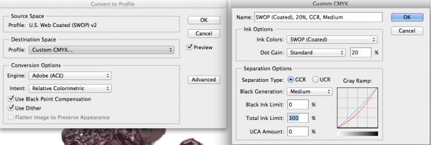

Hi Gordo
I convert images time to time from CMYK or RGB to CMY only for flexo. Specially when there is very little black is needed, It does work well for me. Here is Pic of settings I use to do it in Photoshop. Custom-CMY-conversion.jpg
Hi Gordo
I convert images time to time from CMYK or RGB to CMY only for flexo. Specially when there is very little black is needed, It does work well for me. Here is Pic of settings I use to do it in Photoshop.View attachment 4867

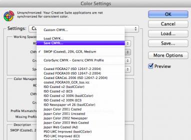

Thanks. This student is looking for an ICC profile rather than what PShop does (secret sauce).
You can save the custom Photoshop separation setup as an ICC profile using the same menu where you access the Custom CMYK dialog box. Please see the attached screenshot.
