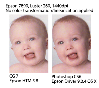

Regardless of what I try, the result is always that prints from CG7 come out slightly brighter (scan attached). Thanks for any help.

I think that the ColorGate version looks a lot closer to the original PDF test image, the baby should have a VERY light complexion with not too much pink when compared to the original colour managed PhotoDisc RGB test image (presuming your example image is accurate).
The scan is not really color accurate, sorry, my intention was just to show the difference.

I do have a spectro. But I've been printing with the Epson driver for quite a while now, I did extensive testing on things like color accuracy (using custom ICC profiles of course) and I always felt that the driver produces excellent results. My main concern at the moment:
- Photoshop/Epson driver prints the darker/more saturated version
- Dinax Mirage does not use the Epson driver directly, but contone libraries provided by Epson. The prints come out identical to the those from Photoshop.
- CG7 also relies on Epson's HTM module…and prints something completely defferent.
_If_ I would run ColorGate in Non-HTM mode where it uses it's own screening technology and so on, it is as clear as day that there will be a difference. But with HTM, I can't think of a reason.
