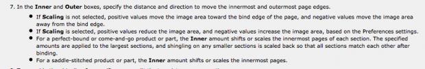

Shingled a job today in preps (signitures/layout details/inner). My question is should this be a positive number or a negative number for the amount I want to shingle? Seems to me when I was using preps years ago (2009) it was a positive number. The job I just worked on yesterday I needed to enter a negative. Is this something that may have changed with an upgrade? I don't see anything in preferences about this...
What version? Unless they changed it in 7, a positive value in the Inner dialog will shift pages toward the bind. I would check the manual just to confirm. Here's a screenshot of the 6 manual:
