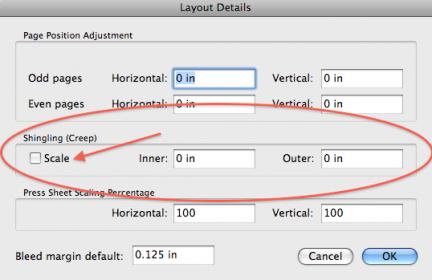

In Preps 5.3 and Preps 6 there is an option for creep scaling which scales the page in the horizontal direction. It's not enough of a scale to notice in most cases but it allows you to shingle pages that crossover.
The only way to preserve the borders AND the cross-overs AND not adjust the relative position of different elements on the page (by moving images within their clipping frames and moving objects closer to each other) is to disproportionally reduce the pages from spread center in the X axis only. Every four pages on a final "signature" would have the same percentage reduction and all four page groups would be different from each other. I've never done that, but would probably do so with a job like that. Shingling algorithms are usually linear, which doesn't accurately model reality (while the pages in the middle lose width, the outside pages also gain width, and the effect grows non-linearly with increasing book thickness), so even going to that extreme doesn't guarantee precise results.

It looks like Joe's solution would be the best way to go but I did a test and it looks like you would have to print out each signature at different percentages. It would be little cumbersome but not nearly as bad as my solution.

No, you do not have to print out each signature at different percentages. You put the creep amount in and then check the box for creep scaling. Ir works the exact way as creep instead of moving pages it scales them in the horizontal direction. As DCurry mentioned you do need to upgrad to 5.3.3 to get this feature. See attached.

We did try this, and maybe we are not doing this right, but we are putting in our shingling dimensions into the inner .135 to be exact, then selecting scale.
When we do this it appears that maybe only the left side pages are being effected, and some are going the opposite way. Do we put in a negative value?
