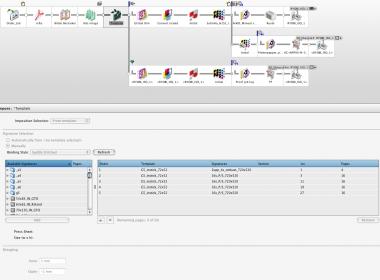

Hope this clarifies. In the preps template you just layout the imposition.
In the workflow in Apogee, when you select the template yoy can move inner pages towards spine and outer pages away from spine as in this screendump.
If you use a JDF I don't know how to do it. It is visible as the box for expected pages move, also you will see the cropmarks move. We allways do an imposition plotter and there you can measure the difference.
Why it is done like this is so that you will be able to re-use the templates for different paper types. ;)
How do I get a better view on the screen dump?? well PM me if you want it larger :)
