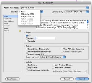

We are preparing to change all our pdf export presets in InDesign CS4 to the pdf/x-4 standard. On a couple of our machines, some of the standards are greyed out, both x-3's and the x-4.
Even if you choose the preset of the pdf/x-4:2008, the standard defaults to "none" on these machines. It's really weird.
I have no idea where to start. Does anyone know if this would be a Preferences issue preventing these selections? Plugins? Permissions? Bad install?
Thanks in advance.
Btw, these are Leapord OSX 10.5 machines.
Screen cap attached.

I am limited to IDCS3 and Tiger 10.4.11, so I will not be much help. But you might want to get the latest for both Leopard (10.5.7) and IDCS4 (6.0.2). There were a lot of reports initially of problems with 10.5.0 and IDCS4 at the InDesign General Discussion Forum at the Adobe site, so you may want to search there:
Adobe Forums: Forum: InDesign
Al
Problem solved. Some of the machines had color management turned off, so it didn't allow for those standards to be used.
