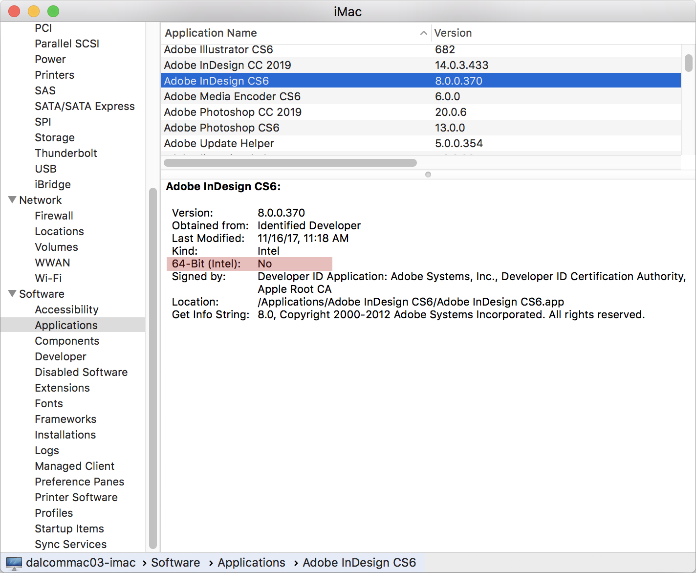

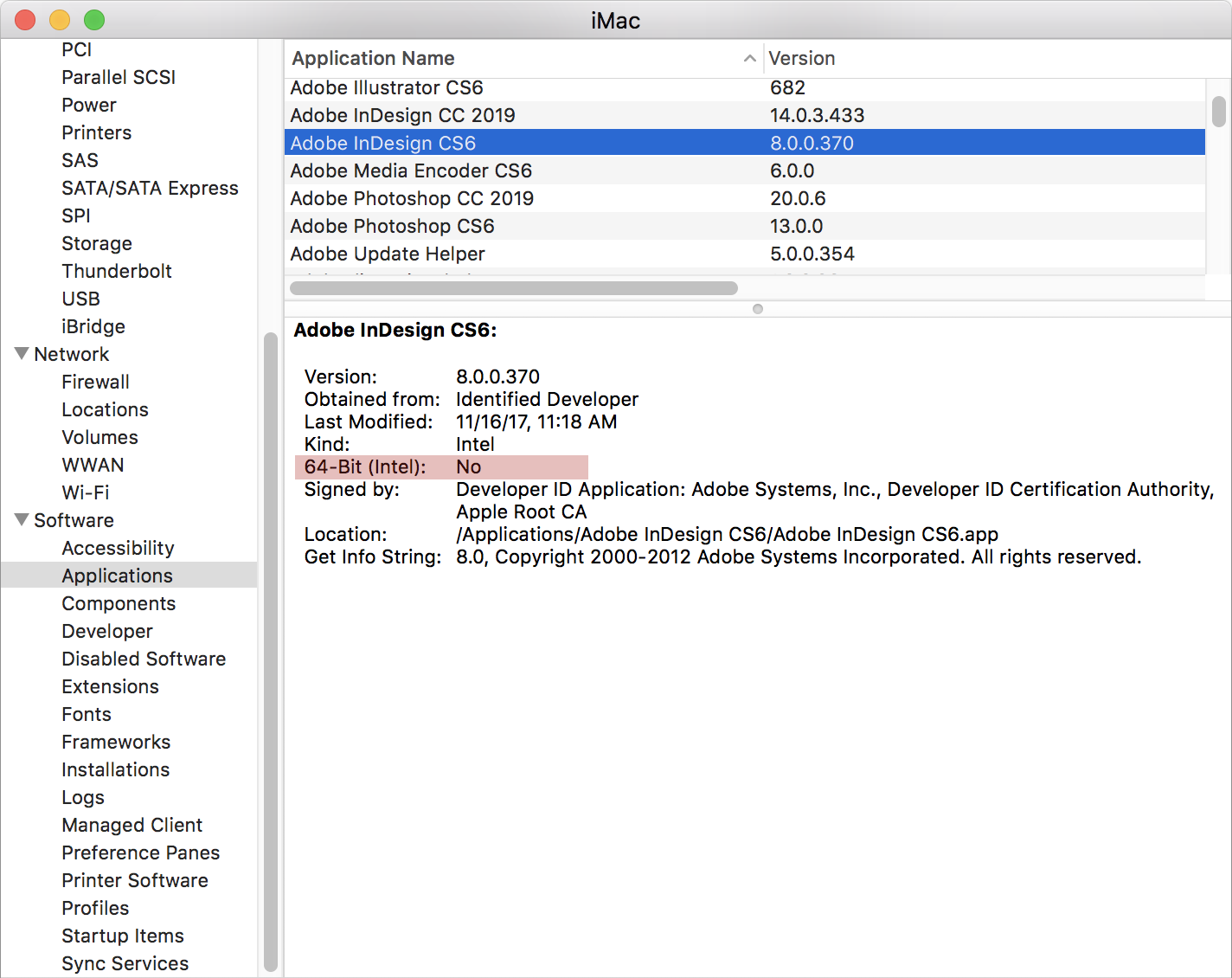

" Also, how can I determine if CS6 is 32- or 64-bit? The "Arch (MacOS)" column says "64 bit" for InDesign CS6; don't know if that's for the OS or the application "
fyi for anyone dropping by …
top-left menubar … apple-icon () … about-this-mac … system-report … software … applications … “64-bit: yes/no”.
