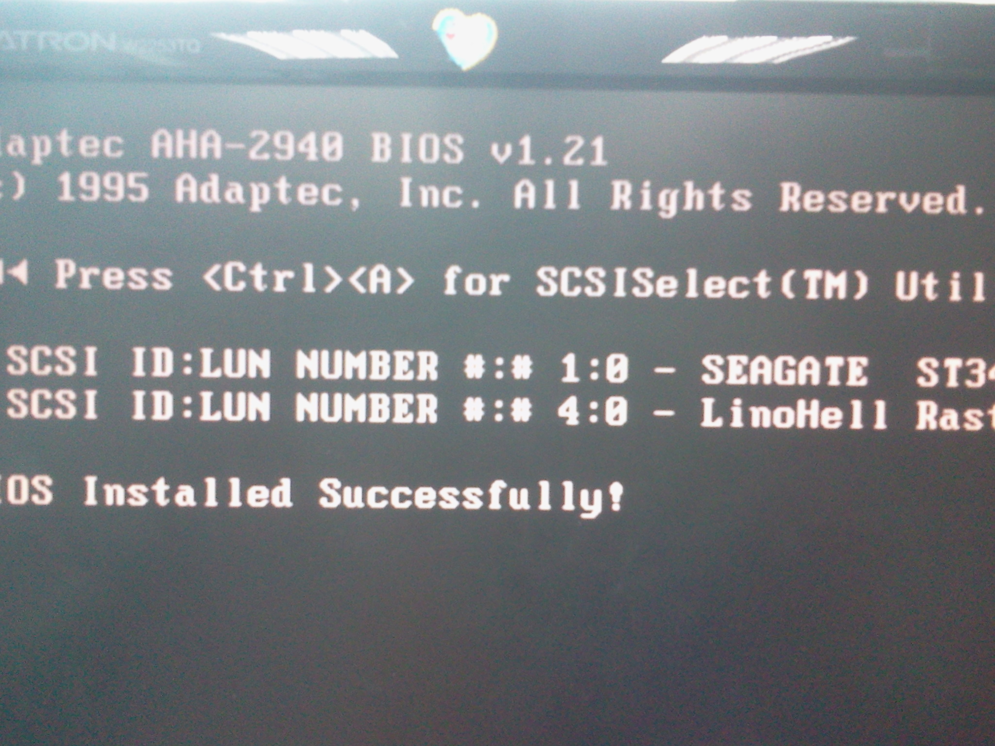

Can you see this two SCSI number when the computer boot up.If not then you have hardware problem.ID 1 is harddisk , ID4 is the board in delta tower.If your hardware is O.K. then you should try to install software.
