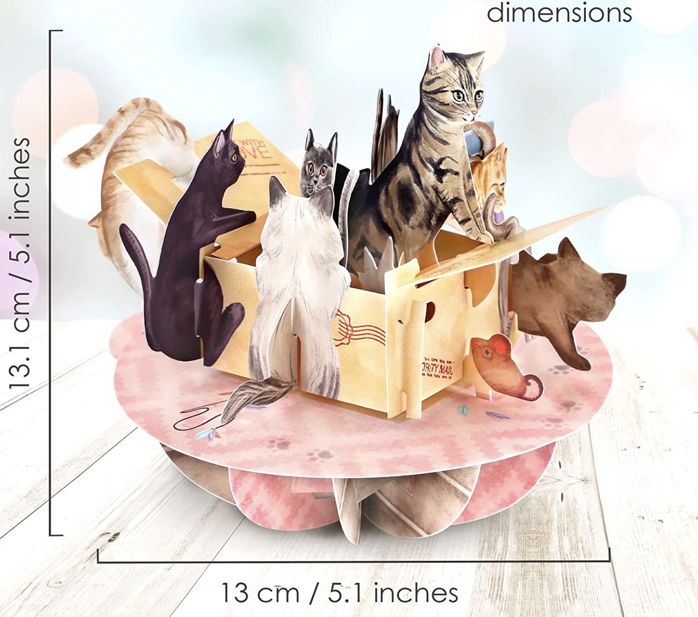

If I wanted 1000 of this kind of thing attached would this be die cut? ....... I would possibly want 5000 ongoing order but for the first batch to test in the market I dont want too many in case I need to change anything in design via market feedback.

Find someone that has a digital die cutter for the first sample. Then take that to a bindery shop that does die cutting and see if they can produce it. Get estimates from both and go from there.
