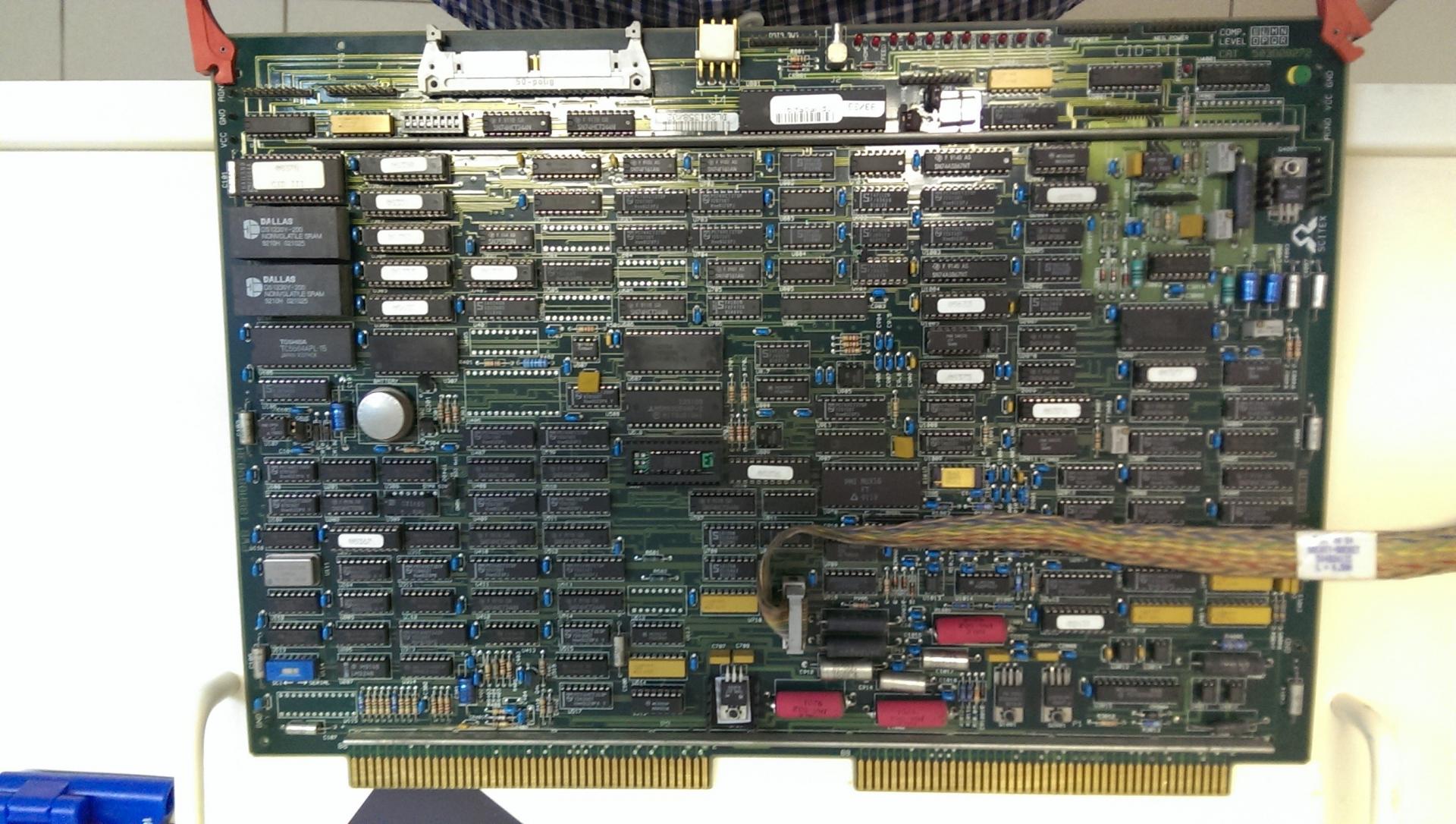

Hello!
I have experience in fixing F516 Smart Watch error at Dolev.
I fix it via replacing some chips at CID board (see it photo) of this imagesetter.
Is this relevant topic? Or you have already repaired your Dolev.
Have a nice day!

Hello,
Can you tell me what chips do you service on this board?
Thanks
Hello,
I have Scitex Dolev 200 got the Smart watch error. I tried modifying on the CID board the time keeper chip Dallas DS12216 with extermal battery. Tried upgraded time keeper chip DS11243-120. Replace the 3 Nonvoloatile SRam Dallas DS1230y-150.
But still get F516:Smart Watch error.
