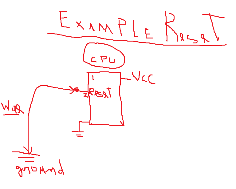

Hi attached is there the scheme for to do it.
Let me know
