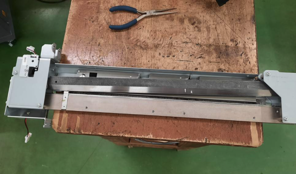

howdy all, does anybody have experience with sharpening rather than replacing a $2000 cutting unit on a DC 618? Anybody sell rebuilds cheaper than 2K? TIA

And it looks like the assembly probably doesn't allow for a shorter, sharpened, blade.

We went down this exact same issue with our Duplo....after much research we just bit the bullet and bought a new blade, was around $2k CAD. It sucks but man we must have put over a million sheets through that thing before we replaced. That machine pays for itself over and over......

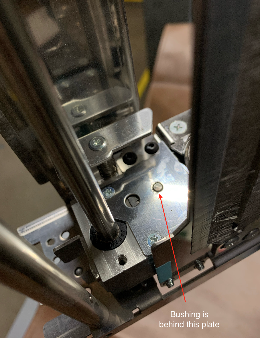

Sorry for never replying, never got a notification. Update on cutter. We discovered there were a couple of things going on that we're not actually a dull blade. the most impactful was that residue from cutting pressure sensitive was sticking to the blade causing other cutting issues so we stopped cutting pressure sensitive and we didn't have the problem anymore. We are now finally having real blade issues from wear now at 3,500,000 cuts. I would say a 2k blade is more than worth it! The other bummer was at about 1.5 mil we had a bushing on a slitter fail, the factory fix for that is $900 for two new slitter wheels (can't buy the bushing) and interestingly enough the new ones have an upgraded bushing so they would never have that problem again. the company says that it is not a known defect however, I think it's BS when you change the bushing type and don't offer people an upgrade even at a discount. That said, I was able to fix the existing bushing by melting a piece of plastic from a pen cap inside where the missing bushing was and we've put another 2 million cuts on that thing without my homemade bushing failing and it works perfect, so I still have my back up set of slitters...
