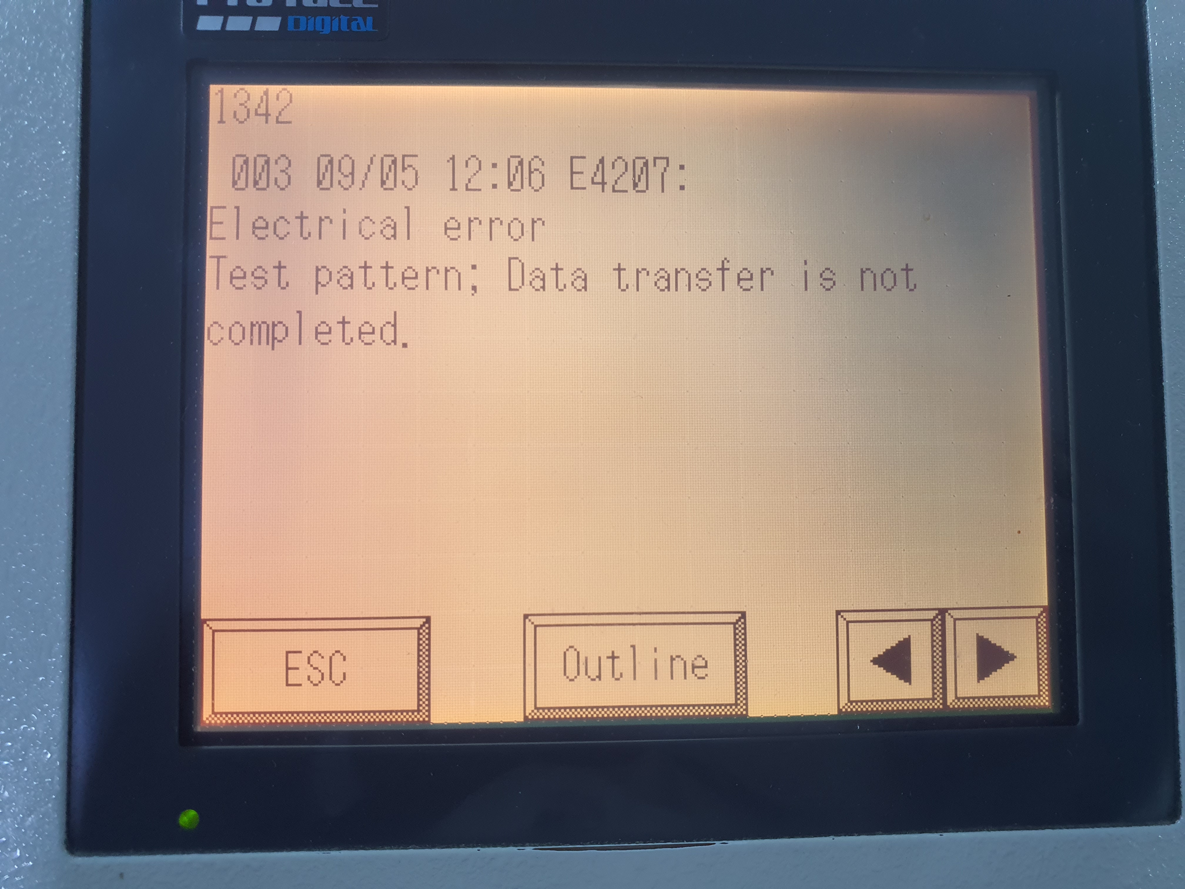

Dear friends,
I have a problem, error code E4207
Electrical error, Details show Test pattern data transfer is not completed. The problem occurs during exposure. Please kindly advice on what could be causing this.

Dear sir,
Thanks for replying. The error code is E4207 Electrical error. After I press the details, the message shows Test pattern; Data transfer is not completed. The problem occurs during exposure.
According to manual.
A problem with the image processing system. Remove the
plate and restart.
Check the image system board and cable between RIP and PTR (main unit
and head) for poor contact.
