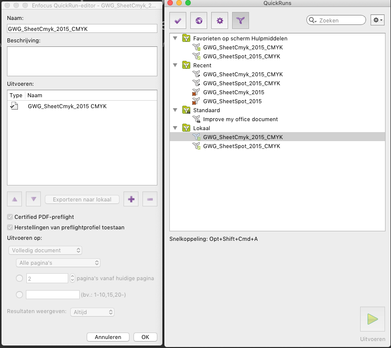

Is there a way to prevent the Enfocus Navigator Window popping up after a Quickrun? In prefs I can only chose to either show the Navigator, or the Preflight Rapport.
I want neither, just the green checkmark, that can opt to click, not a window I'm forced to close every time.

Thanks for your quick reply. The Quickrunn just checks whether the PDF is GWG_SheetCMYK_2015 CMYK compliant.
If I select 'Certified PDF Preflight' the box 'Show Results' is greyed out. (please see screenshot)
With Certified PDF on I am afraid you can't turn it off.
To be honest I am not sure you want to as any warnings or errors from the preflight will be hidden.
You also have the option of course of not running the Preflight Profile as a Quickrun.
