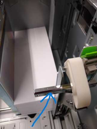

we just got our Iridesse printer and trying to run envelopes has been a challenge. What trays and what setting do you use in paper catalog.
Any help would be greatly appreciated
thanks
Uncoated 177-220 gsm
Auto Tray selected and loaded in both trays 6 & 7 with the envelope/card bracket installed in both trays
I keep the back hold down off the envelopes and that seems to help with feeding
Not all envelopes run the same. I’ve run diagonal seams for a long time and now I have issues with wrinkling. Could be a different convertor but I do notice more of a twist to the envelopes I’ve been receiving. Switched to digital side seams and have no issues with feeding or wrinkling.
If you have issues with feeding, try smaller stacks until you figure out what the maximum height of the stack should be for consistent feeding.
thanks for the info we will definitely try it
