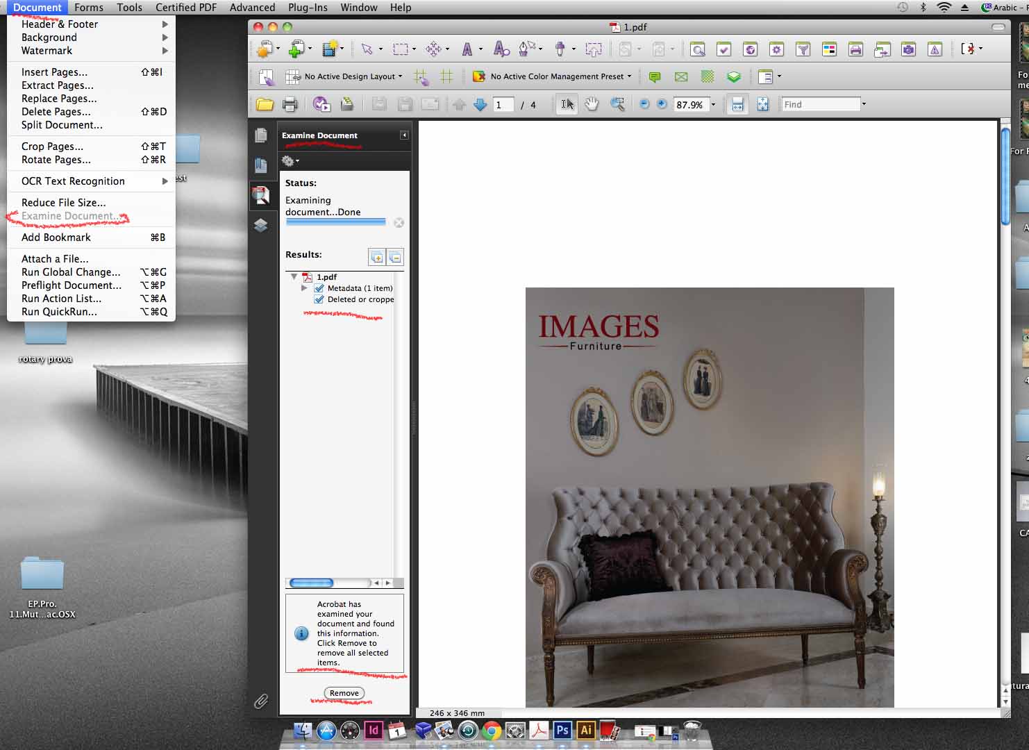

if i make examine file from document menu in any pdf file
there is left menu appear for metadata
which i can remover from remove button on bottom
I need to know what is metadata and if its change the file data and photos or not if i remove it - and whom concern on metadata? ?
the photo blow may explain more

How can I know If it is critical or not important before i remove it?:confused::confused::confused:
I you don't know what it is, then I wouldn't remove it OR make a copy of the file before removing it and test in your workflow. (Metadata is in practically everything these days, Unless the metadata significantly bloats the filesize, I wouldn't waste any time worried about this) . "How can I know if it is critical or not important before I remove it?" is the same as "If i do ______ will it hurt?" no way to know until you do it, or rely on past experience....and that isn't always accurate.
Why do you wish to remove metadata? Just because you can do something, does not mean that you need to or should do something.
I understand the need to sanitise data depending on the intended distribution. In many (but not all) cases, retaining metadata is very valuable, however it of course depends on what the data is and what use the file will be put to.
WHAT metadata has been found that could potentially be removed? In the left hand panel you would need to open up the arrow to expose more info about the metadata.
