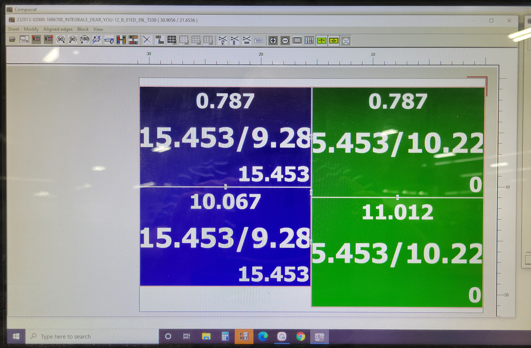

I am exporting to jdf post pres from my imposition file so that the compucut of the gullotina polar 115 plus interprets it the question is that it seems that the cut blocks do not appear (the technicians tell me) however when I edit the jdf I do see this information.

prepressdork
Without doing anything at all in CompuCut other than opening the JDF file, this is what I get.

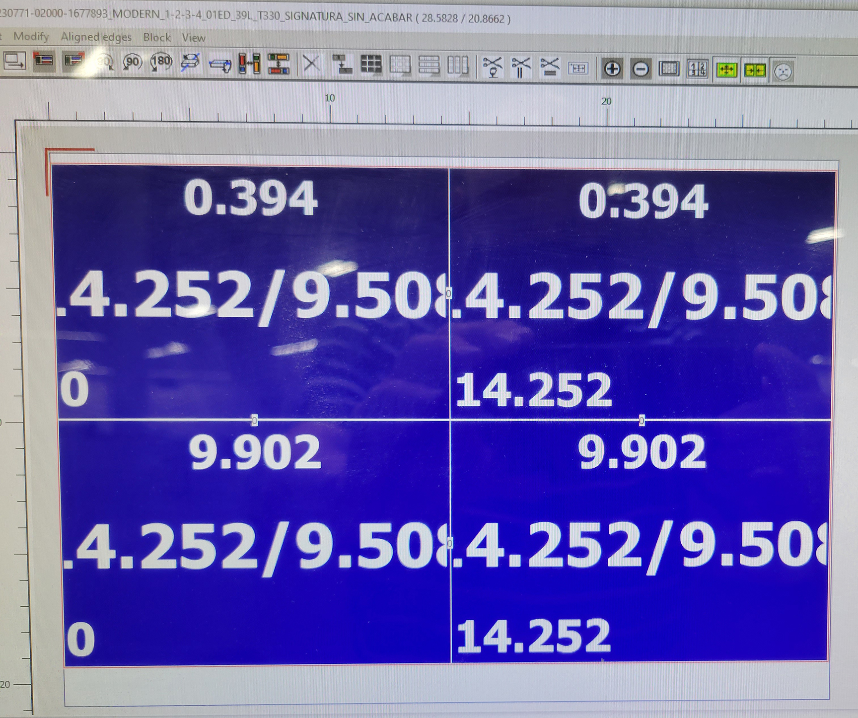

xmoles
Well ,,, please you can check this jdf
  • 230771-02000-1677893_MODERN_1-2-3-4_01ED_39L_T330_SIGNATURA_SIN_ACABAR.zip

xmoles
sorry @ prepressdork
, in the jdf process did you do anything special so that they were processed correctly?
Could you give me some information about the processing characteristics?
thanks for your help
prepressdork
I did nothing special other than just opening the JDF file.
As for the processing characteristics, I am not sure how to answer this question as I am not all that familiar with CompuCut. Can you give me some examples of the processing characteristics you're looking for?
xmoles
I find it strange, when the technicians process them they tell me that the cutting measurements are missing, but if I edit the jdf file I see them, they are in inches.
