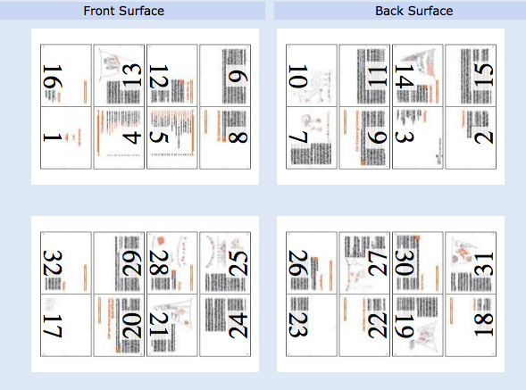

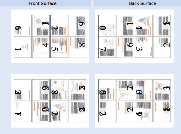

Sometimes the fonts in the interface gets messed up, it seems that the Workflow uses another font than it did before and it's very disturbing. I attached two images where you can see the problem. There is a temporary fix and that is to empty the font cache, I use the freeware application Onyx for that, but the problem reoccurs after a while.

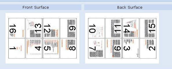

If I open the Client application on another Mac, or the Client on the XMF server-machine, the font is also different (and as how it should be!)
