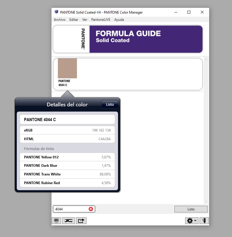

Hi people!
My Pantone Formula Guide is not very up-to-date, and does not contain the values for Pantone 4044, could someone provide me with this formula?
Thanks in advance!

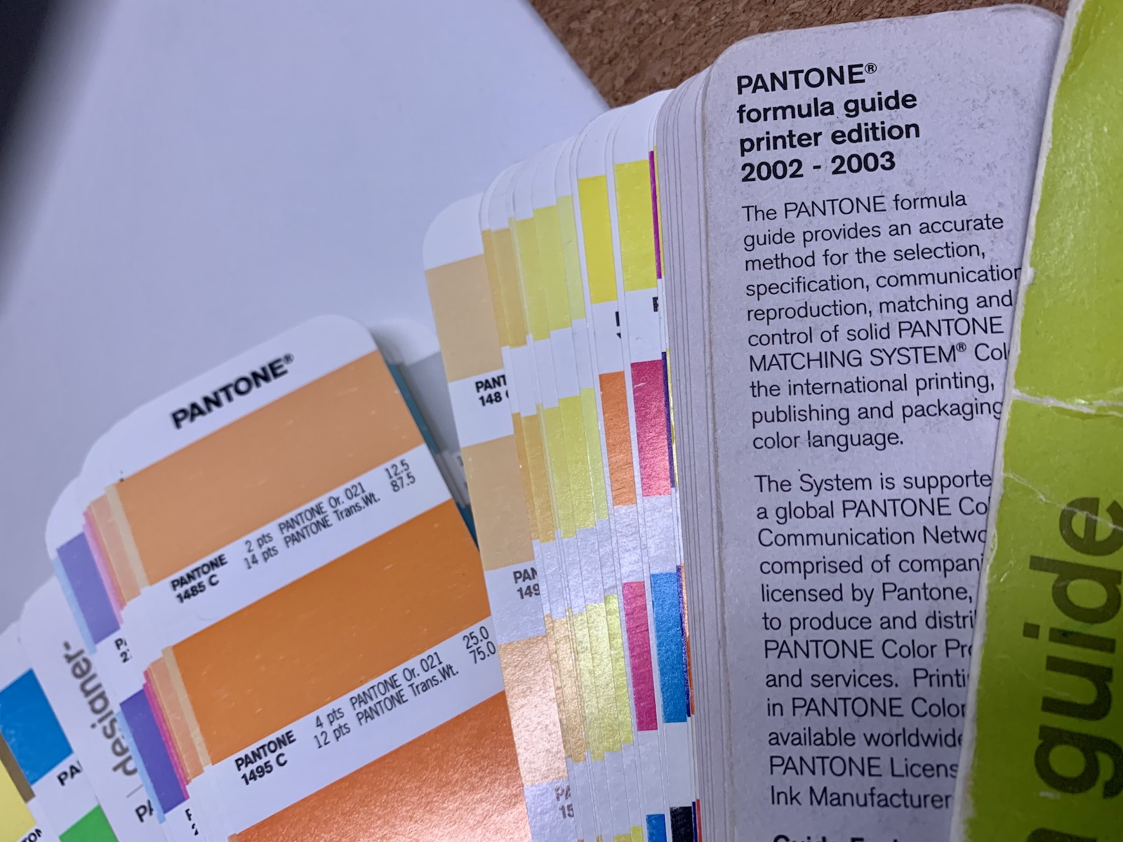

I need the ink formula... Our business is very small and, truth be told, we have not had the need until now, I recognize that my Pantone Formula Guide is very old, the 2002-2003 edition (our Pantone Color Bridge guide is more current), but times are tough for our business, and it is not possible to purchase a new guide now.

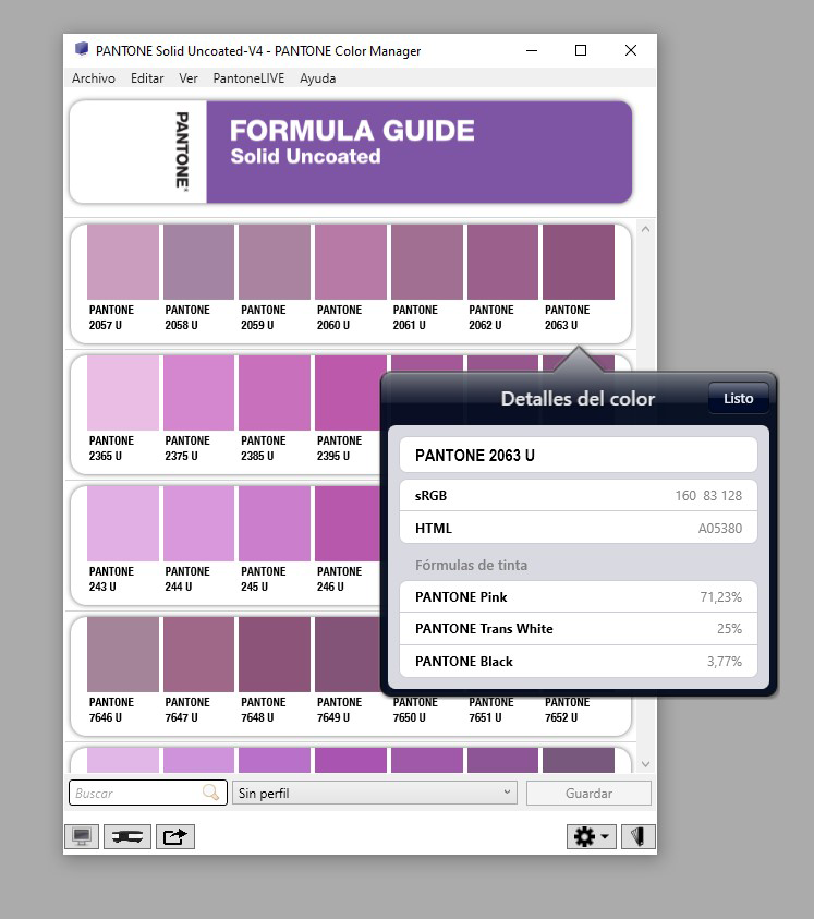

Also i want to know about the formulation Pantone 2063 u please let me know thanks
