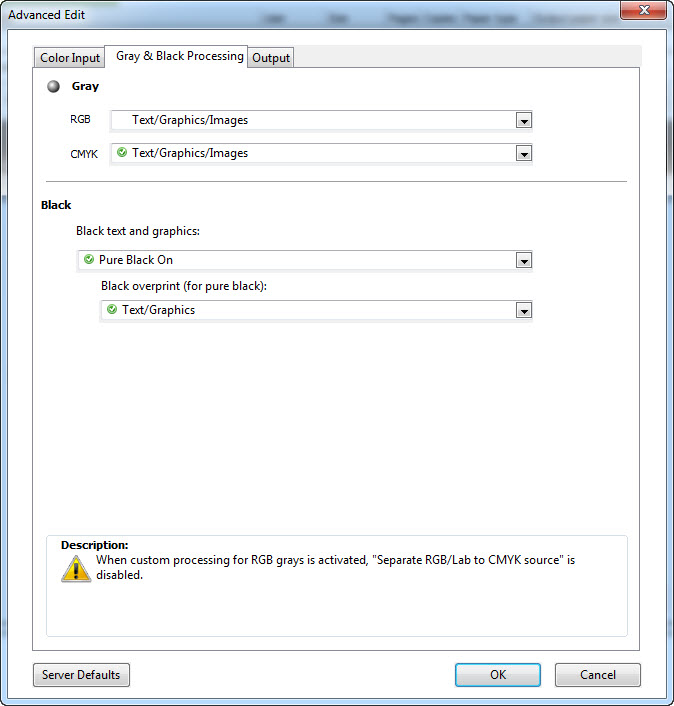

I'm assuming you've looked at the print ready PDF in acrobat and had a look at the Output Preview? Assuming everything is as it's supposed to be there, it could be a Fiery setting.
Drop the PDF into Command Workstation, open up the properties of the job once it's sitting in the [Held] queue, click on the [Colour] tab.
First, select [Expert Settings], then go to the [Gray & Black Processing] tab.
In the Gray section, there are two drop down boxes.
The RGB drop down box is normally set to "off" by default. This means when an image/object/text in your layout is RGB grey (ie, the R/G/B values are all the same), it gets printed as rich black.
The other two options allow the Fiery RIP to print "Text/Graphic"s or "Text/Graphics/Images" as true CMYK black (K only).
You'll only see a difference here if the object in question here is an RGB object, not CMYK object. You can easily identify that by looking at the object using the Pitstop Inspector tool.
The CMYK drop down box should be set to Text/Graphics/Images by default. This is what you would need for your purpose.
If it set to "Text/Graphics", then any text or graphics that are K only will print in black, and any raster images will print in rich black.
If it is set to "Off" then any CMYK text, graphic or image object that only uses the black separation will be printed as a rich black. Not what you want for your situation.
The next section down is the black section.
Basically it should have "Pure Black On" and the second drop down box should be set to "Text/Graphics".

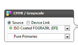

Now that you're done in the [Expert Settings] section. try looking into the [Basic Settings] section.
Try setting the second drop down box in the CMYK/Grayscale section to "Pure Primaries". Basically when "Pure Primaries" is on a file that is imported to the RIP with C5 M0 Y0 K50, it will print that way. Sometimes Fiery's like to add a bit of extra toner to the output file to enhance the print quality based on the calibration or the printer it's tied to - it can be a very annoying feature when you have to do finicky colour matching.
It's a long shot that these settings will work, but what have you got to lose? :)

But seriously thank you for this long write up and for including screenshots. Some of my settings matched, some didn't but I've adjusted all now and I'm going to run a test. Just curious why you have ISO Coated as your source profile? The tech the came out and set us up told us to use Gracol (but he also admitted that he had no idea why and that we should do whatever we want).
Also, some of these settings make it look like we would be better off with our black intended files to be CYMK files that are only using K. Correct?
