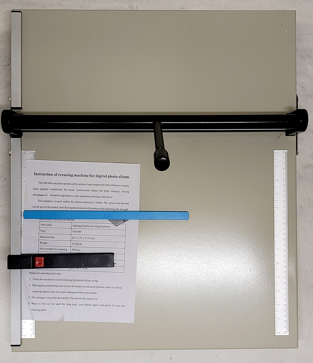

If this 20" hand-press scoring unit is useful to you - i have for sale for $ 100.00 plus shipping by UPS ground from CT. you can email me at [email protected]
